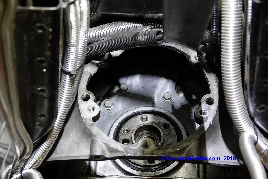

Rich Z 04-18-2019 12:22 PM
Well gee, now just how in the heck would you use a dial indicator on THIS bell housing in order to check alignment?
http://www.corvetteflorida.com/pics/...ousing_101.jpg
And yes, that is looking at the bell housing on my C5Z.
navy2kcoupe 04-18-2019 06:00 PM
Old picture, or do you have it apart again?
But to answer the question posed.........I would get someone that knows what they're doing, to do it for me. Trouble is..............finding someone that knows what they're doing!
Good luck whatever you decide to do.
Andy
Rich Z 04-18-2019 08:16 PM
Picture was taken yesterday (04-17-2019).
So yes, the car's guts are laid bare again.
And also yes, I have someone who I believe knows what they are doing looking at it.
