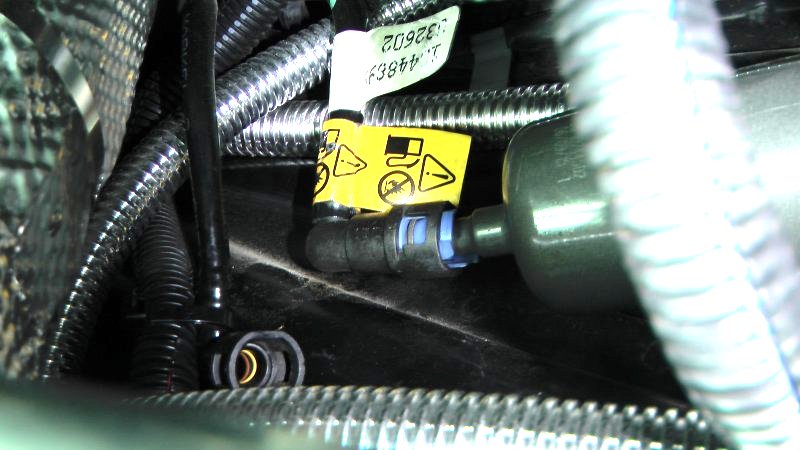

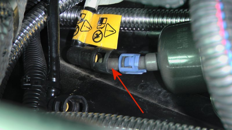

So I got the car up on the lift and checked out what had happened. I really thought something broke on or in the fuel pressure regulator, but when we pushed the car into the garage, there was a pretty obvious gas leak dripping from somewhere, so anything was possible. I saw gasoline dripings on the skid plate underneath the driver's side fuel tank, so I pulled the inspection panel to check out the fuel pump connections. They all seemed to be OK from what I could tell. So I started looking elsewhere on up the line. I looked up at the fuel filter and the problem was then obvious.
Apparently the fuel line connector on the input of the fuel filter had popped off of the filter. Not sure why that happened, but I think I might have loosened it when I was working on replaced those fuel lines with the teflon stuff not that long ago. I remember thinking I wanted to go ahead and replace the fuel filter, but I had trouble getting the connector off and decided to just leave the filter there. So maybe I had partially depressed the restraining tabs and didn't go back to make sure they were tight afterwards. So over time, it just worked itself ALL the way loose till it popped off. :shrug01:
Anyway, I just pressed the hose end back on and heard a nice solid *click*, and hopefully that won't happen again.
Could have been a LOT worse. Thankfully this was an easy fix.
