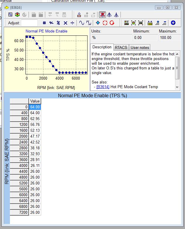

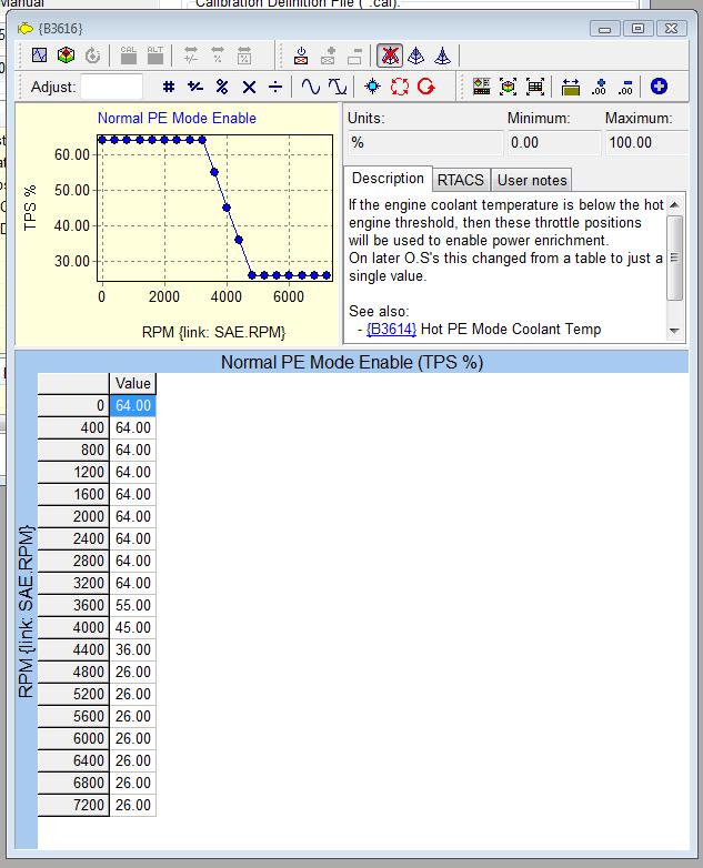

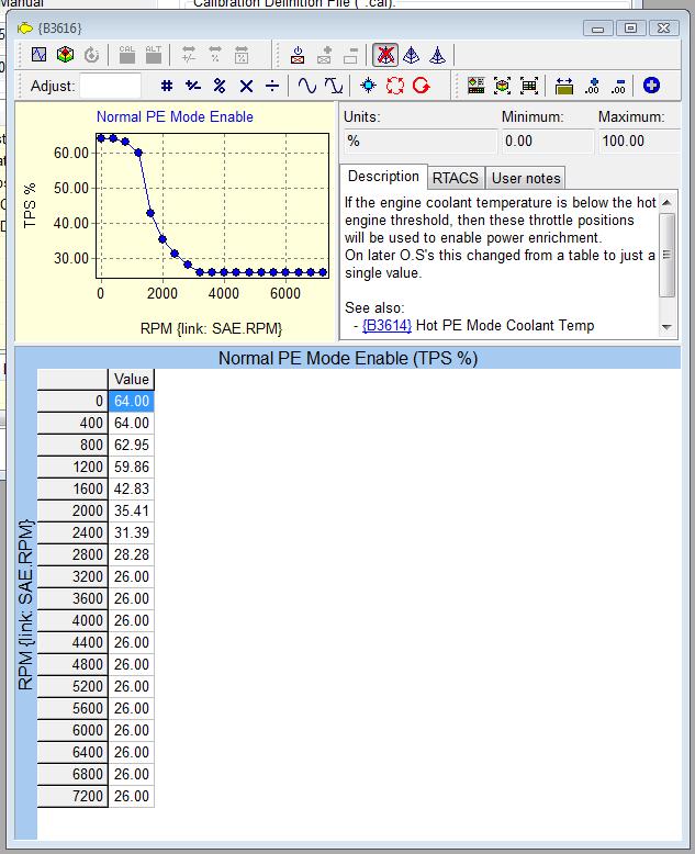

Copied the following tables from a tune I got from Brett on EFILive forum.
{B3606}
{B3613}
{B3618}
{B3647}
{B3616} Normal PE Mode Enable
Copied from stock Z06 tune.
