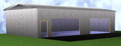

Crawfordville is about 20 minutes south of Tallahassee. I've been pricing metal buildings, since I thought that might be the best way to go about it. But heck, maybe not....... I've got a 42x20 foot concrete building for my animals that was built around 17 years ago and cost me somewhere near $30K back then. The size of the garage I've been getting prices on is 50x30 inside dimensions with 12 foot ceiling and two 16 foot wide doors.
Kind of like this........
