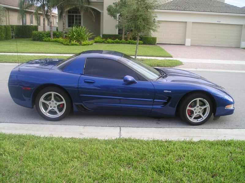

Well OK, I guess I am gullible. When someone says something, I tend to take them at face value and believe what they say. One of my major failings, for certain.
In any event, last year when I was looking for a Z06 Corvette, I first saw an ad for one that looked promising on Z06vette.com at this thread (which apparently has since been edited into obscurity):
http://www.z06vette.com/forums/showthread.php?p=976294#post976294
I further tracked down this car to being offered on Ebay. Anyway, yes, I was a complete noob at C5 Corvettes and the Z06 variant, so when I saw this picture among others, it really meant nothing much to me concerning the wheels as I just didn't know enough about the models to realize there was an issue with this car.
http://www.corvetteflorida.com/pics/rini/z06_original_02.jpg
After all, I had actually been looking at mostly regular C5s and nothing looked out of the ordinary to my untrained eye. And as you will see in some screen shots of the Ebay auction, this seller was presenting himself as a dealer (kellychevroletflorida), and claiming the car was in MINT condition. Now "MINT" to me simply meant adj : as if new; "in mint condition". So quite frankly, with the ad taken at face value, I fully expected that car to be "as new".

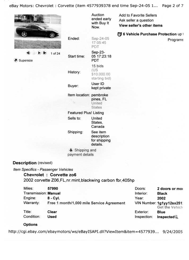

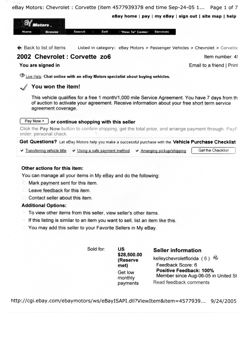

So let's look at the pages I took as screen shots from the Ebay auction. First off, I apologize as when I took the screen shots, evidently there was some slight truncating of the right edge of the page. Nothing serious, but it does cut off a few letters of each line.
This page merely shows the ID name of Mike Rini that was being used for this auction, indicating that he was, in my opinion, representing an established dealership running this auction.
Now in this next page, notice that the ad claims that the vehicle was INSPECTED
Well I find that just a bit difficult to believe. Neither of the front turn signals were working when I picked up the vehicle. Matter of fact, the lamps were clearly shattered as the amber glass was loose inside the housing and visible through the clear cover. I doubt this would have passed inspection. How those lamps became shattered, of course, is matter for some conjecture as well. Secondly, the front tires were bald down to the threads on the inside edges and certainly an inspection would have clearly shown that to be an issue as well.

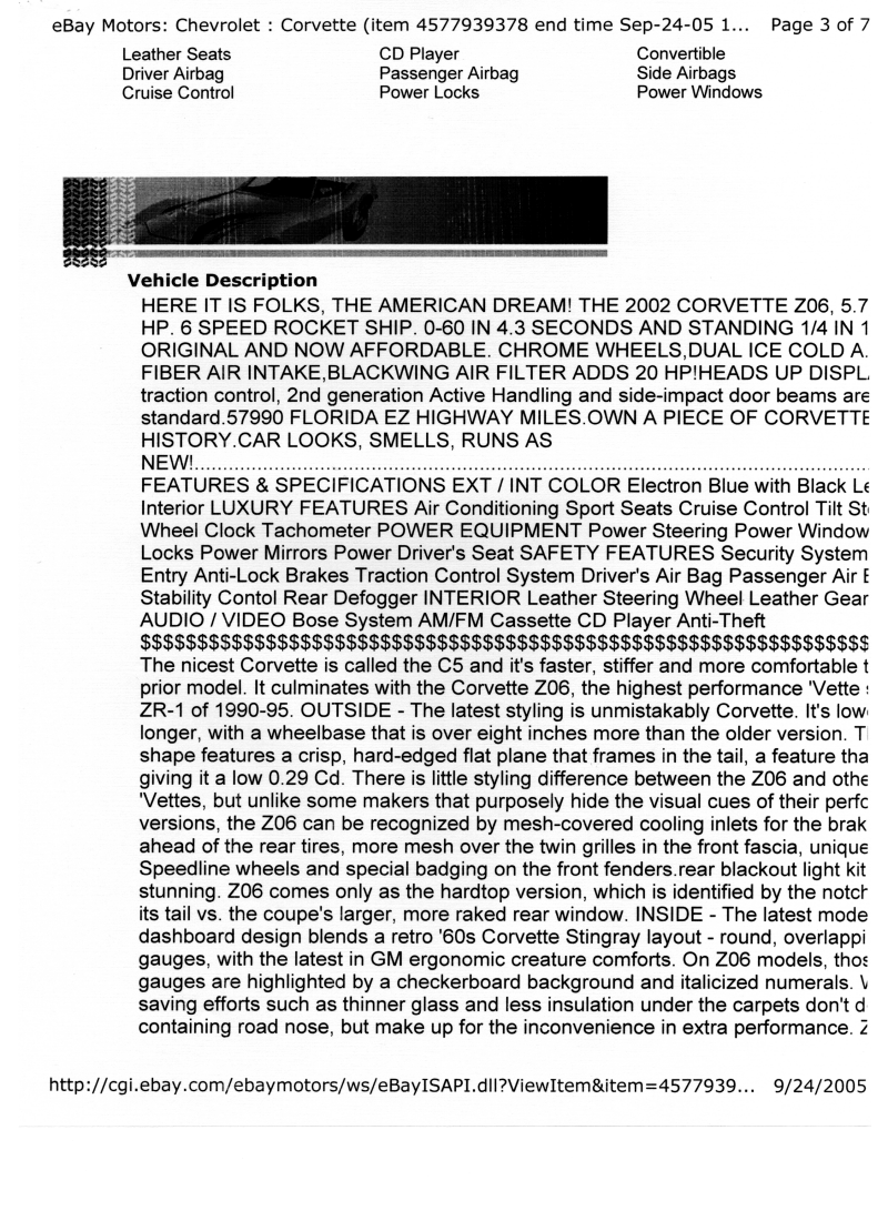

On page 3, this is the beginning of the actual textual description of the Z06 being offered in this Ebay auction.
Notice that it CLEARLY says CHROME WHEELS. As best I can recall, the 2002 did not come stock (mint) with chrome wheels at all. Even considering that chrome wheels MAY have been on the vehicle at the time of the sale, they certainly were not when the photos were taken.
Also notice the mention of "EZ HIGHWAY MILES", which is quite puzzling because in further correspondence with Mr. Rini, he claimed the car had been taken in as a tradein, and he had no real knowledge of any history at all on this car. I guess "EZ HIGHWAY MILES" has the disconcerting habit of making the Z06 standard wheels change into regular C5 wheels, and cause some sort of impact to shatter the front turn signal bulbs. This apparently also caused very odd wear on the front tires to take the rubber off down to the threads on the inside edges. A curious situation that when I had an alignment done on the car after buying new tires AND wheels, was commented on by the people at Champion Chevrolet in Tallahassee that the current alignment of the vehicle could not have possible caused that sort of wear on those tires. The wear on those tires was done while they were on another vehicle and at sometime put on this Z06 before I purchased it.
Oh yeah, the "SMELLS, RUNS AS NEW!" quote needs mention as well. I never knew a new car to smell like some overpowering strawberry scenting that Mr. Rini had put right at the center A/C vent.
You will also note that Mr. Rini claimed in that ad that this vehicle came with Sport Seats, which is completely untrue. The car has the standard seats within it, but certainly I did not know the difference at the time to be able to tell.

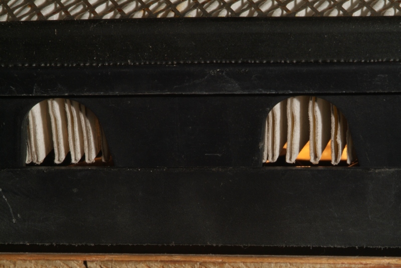

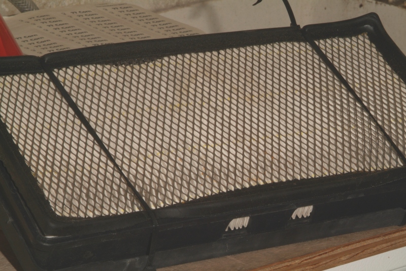

Also please note the comment about the car coming with a "BLACKWING AIR FILTER". This is absolutely untrue. It had something akin to the "wire tie" mod done to the original air cleaner, but was done in such a botched up way that outside completely unfiltered air was allowed to come in UNDER the filter element into the air intake system. I did not discover this one until I replaced the air cleaner system myself. But in any event, any knowledgeable Corvette person would have clearly seen and known that the air cleaner was NOT a Blackwing at all.

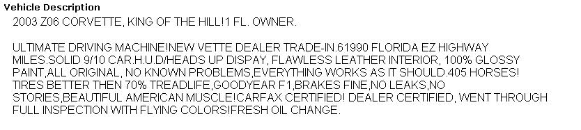

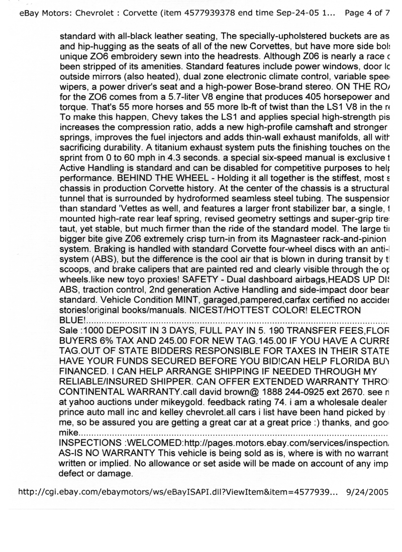

On to page 4 of the auction descriptive text.
In this generic text that was apparently cut and pasted within the ad, there is clear mention (somewhat truncated however) about the Z06 having larger tires with a bigger bite. Obviously this car did NOT have those larger tires, as the wheels and tires were off of a standard C5 and NOT what came standard on the Z06 at all.
And notice that the vehicle condition is CLEARLY noted as being "MINT". Well to me, "MINT" would not have the following issues that I discovered later on when the vette tech looked it over at Champion Chevrolet, as well as my own discoveries:
As for it being "garaged" and "pampered", the number of rock chips on the front of the vehicle belie those statements. And considering the professed lack of knowledge of the past history of this car by Mr. Rini, I would have to wonder how he could even know such a thing to make these sorts of claims.
- Wheels and tires were not standard for a 2002 Z06
- Both front tires were worn down on the inside edges to the threads
- Both front turn signals were nonfunctional and the shattered glass from the bulbs still within the housing.
- A noticeable scrape mark on the undercarriage of the vehicle.
- The plastic mouldings above both the driver and the passenger doors were apparently cut for some reason.
- One of the floor mat holddowns on the driver side floor was partially ripped out of the carpet.
- The air cleaner was modified in such a way to allow unfiltered air into the engine. The upper portion of the air cleaner is completely missing
- The horn is barely functional, with apparently the low frequenty horn being dead
- The vehicle did not come with the standard Z06 tire inflator in the trunk.

RICH...your kidding right. those were pictured in many pics. the magnesium
is a upgrade from chrome. i offered you chrome and you stuck with these.
sorry, but if you want different wheels thats on you.
mike
>From: "serpenco" <rich@serpenco.com>
>Reply-To: "serpenco" <rich@serpenco.com>
>To: <tensecondmonster@hotmail.com>
>Subject: Wheels and tires problem.
>Date: Wed, 5 Oct 2005 13:56:07 -0400
>Mike,
>I'm really bummed out. Just got back from the Chevy dealer today. Went in
>for an oil change, had to have the front turn signal sockets replaced, and
>got a new set of keys made up. Cost me $600 when all was said and done.
>The corvette tech guy came into the waiting room to show me something. The
>front tires on that car are shot. Showing threads on the inside edges and
>need to be replaced NOW. The wear pattern also means a 4 wheel alignment
>will be necessary when I get new treads put on. The rear ones are worn in
>the center and will need to be replaced SOON as well. I was expecting to
>have to replace those tires, and that isn't that big of a deal, although I
>wish I didn't have to do it right now and fear for them causing me a
>problem if I had wanted to take a trip with that car beforehand. The tech
>recommended that I drive on them as little as possible until I get
>replacements.
>The tech and I were looking things over underneath, as I told him I just
>picked the car up on Friday, and he asked me why I had put stock Corvette
>C5 wheels on a Z06. ??? He said those wheels are what comes standard on
>the regular C5 and NOT an upgrade as you had mentioned in a phone
>conversation with me concerning them. Matter of fact, I looked up the
>original ad you had on Z06Vette.com, and it specifically states "2002 z06
>electron blue,hud,chrome wheels ". Further I checked things out on the
>driver's side door where it lists the tire sizes that are SUPPOSED to be on
>this vehicle. It states:
>Front P265/40/ZR17
>Rear P295/35/ZR18
>What is on this vehicle is the following:
>Front P245/45/ZR17
>Rear P275/40/ZR18
>The wheels are correspondingly smaller to accomodate those smaller tires.
>The standard front wheels are 17 x 8.5 whereas the Z06 wheels are 17 x 9.5.
>The standard rear wheels are 18 x 9.5 whereas the Z06 wheels are 18 x 10.5.
>Now I was resigned to the fact that I would have to get new tires for that
>vehicle, and you indicated that the $500 you knocked off of the price would
>compensate for that situation, but I was not prepared to have to buy all
>new wheels as well.
>Apparently the real Z06 wheels and tires were switched out for standard
>Covette C5 wheels and tires, and I got the short end of the stick on that
>deal. Quite frankly I was (and still am) too inexperienced with Corvette
>style wheels and options to be able to tell one from the other by simply
>eyeballing them. But now that the details were pointed out to me by the
>Corvette tech I talked to at Champion Chevrolet, I can positively see that
>I did not get a 100 percent Z06 Corvette. And those wheels are DEFINITELY
>not a higher value trade up for a Z06 either, as you had told me.
