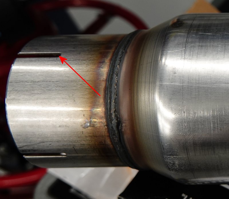

But I have plenty to do before I get to that point, anyway. No sense worrying about tuning too much beyond just getting the car running till I get all the mechanical and ignition issues straightened away. I'm hoping just replacing the O2s and harnesses will straighten up the readings I'm getting off of them. If not, well, SOMETHING else has to be causing it that will have to be tracked down. Heck, maybe the exhaust leaks are throwing a monkey wrench into things.
In any event, some of the exhaust parts came in today, so maybe by the weekend I can start getting the exhaust system straightened out. If not, I guess I know what I'll be doing over Christmas weekend.
