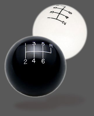

Hopefully next week or so I will have my C6 shifter knob repaired and returned, and get that black ball shifter knob I ordered in so I can try both of them. The one on it now just sits too high for my aesthetic tastes. I'm just hoping the lower knob doesn't change the leverage geometry too much to where I am back in the same boat with an arm wrestling event to shift gears.
