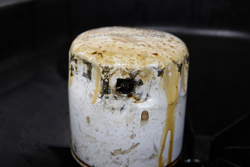

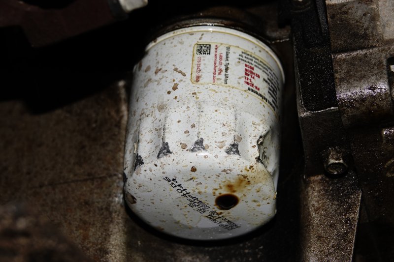

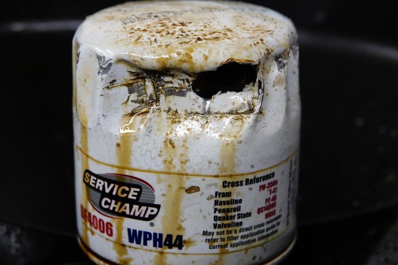

Anyway, when it came time to remove the oil filter, I used my usual tool which is sort of a cap device that I use with my 3/8s inch ratchet to break loose and screw off the old oil filter. Hmm, the filter wouldn't budge. I got out one of my long breaker bars, thinking maybe I had just gotten a LOT more feeble since the last time I took of an oil filter. But the tool was just slipping off the ridges and started to round them off. Obviously this wasn't going to work. So I grabbed another oil filter removal tool I had which is like a big slip joint rounded pliers with teeth on the edges. I got a real good grip on it, but it still wouldn't budge. So I just clamped down harder and whacked it a few times with the deadblow hammer trying to break that filter loose. Well the sides of the oil filter got crushed in with me squeezing on it so hard, and on top of that, the teeth chewed through the side of the filter, and now the old oil was leaking out through the side of the oil filter. I figured I was pretty much committed to getting that filter off myself now. The truck isn't going anywhere.

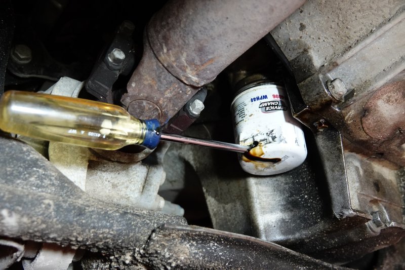

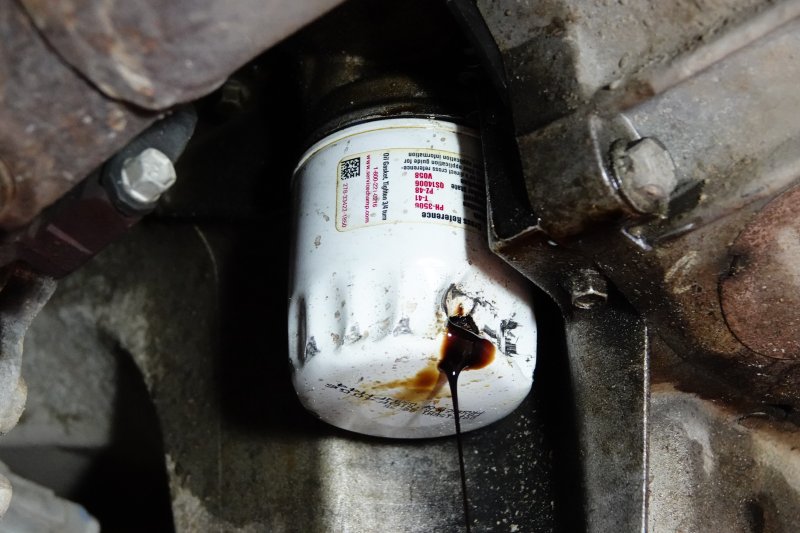

Still no luck after letting the Break-Free set for about an hour, so I figured it was time for the screwdriver puncture method. I had to be careful because there wasn't all that much room to get a good shot with the screwdriver, and I sure as heck didn't want to punch a hole in the oil pan. So I used a smaller screw driver first and easier to punch a hole through with minimal force and maximum control. More oil drained out of the filter at that point. As an aside, I watched a video of a guy using a drill to put the hole through the oil filter, and that really turned out messy for him when the oil drained onto the drill bit and got slung all over the place. That and the fact that I was more afraid of a drill bit going through the oil pan than a screwdriver prevented me from wanting to try that particular method.
So with the small hole through the filter, I got a larger diameter Phillips head screwdriver and pushed that though the existing hole. So now I had the screwdriver through both sides and could get some leverage to twist off that filter. I wanted more surface area than the small screwdriver would provide, because I was concerned that the smaller screwdriver might wind up just slicing through the side of the filter like a knife blade. And come to find out, I'm pretty sure this was warranted, because even with the larger screwdriver, the side of the filter WAS starting to slice apart before the filter FINALLY started to loosen up and turn.
Whew! What a pain in the butt that was! Now it was around 2:30 and rain and thunder had set in, so I really didn't feel like running out to Zaxby's. Not to mention that I was sweating like hell, so not really fit for going out into public anyway.
So the rest of the job went easy, like it should have. Torqued the oil drain plug (24 ft/lbs), put the new filter in face. ONLY hand tightening it! and then filled the crankcase with new oil and then ran the engine and checked for leaks. Good to go.
