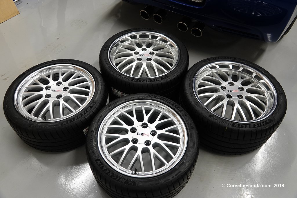

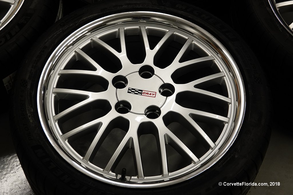

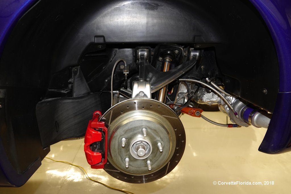

Anyway, push come to shove, the closest I could come to what I wanted was if I were to go with 18 inch wheels on the front with 265/35/18 tires, and 19 inch wheels on the back with 295/30/19 tires. The 305/30/19 tires would have worked, I think, except that the wheels are only 10.5 inches wide, and those 12 inch tires are just a tad too wide for the wheels. At least according to the chart I will attach at the end of this message. I did NOT want to start my search all over again looking for a style of wider wheels that I liked just to get those 0.4" wider tires.

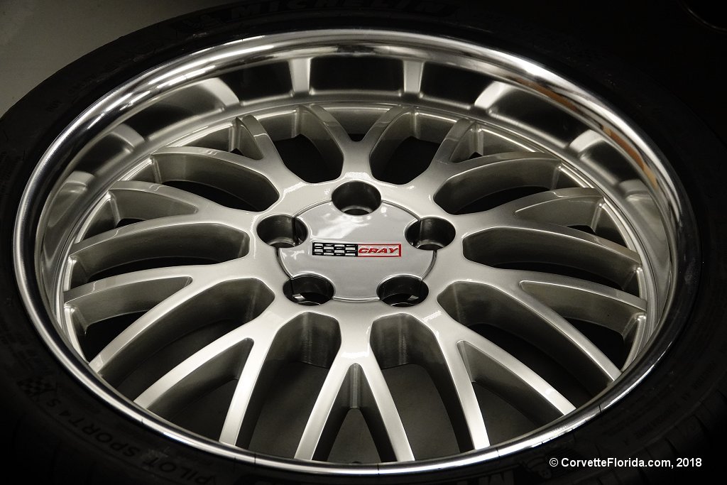

The wheels I have decided on are the Cray Manta Hyper Silver w/ Mirror Cut Lip model (https://www.elementwheels.com/wheels...scra-19105cmhs). But honestly, I'm still leaning a bit to the chrome version instead. I do like the wheels to be blingy. But after having those chrome wheels I had on the car get destroyed at Aaron Scott's place when he left the car out in the elements nearly the entire time he had it, I guess I'm a bit more leery of chrome wheels now.
I had considered having TPMS sensors installed since the place I will likely get the tire/wheel package could install them right then and there, but from what I understand, it takes a TECH II to enable the TPMS system in the Z06. Which I just do not have access to. Oh well....
I'll likely put those wheels and tires up for sale to get rid of them. Don't need them cluttering up the garage, as I STILL have those older chrome plated ones sitting underneath the workbench there.
Unread 11-15-2018, 11:11 PM   #2
Posts: 15,134

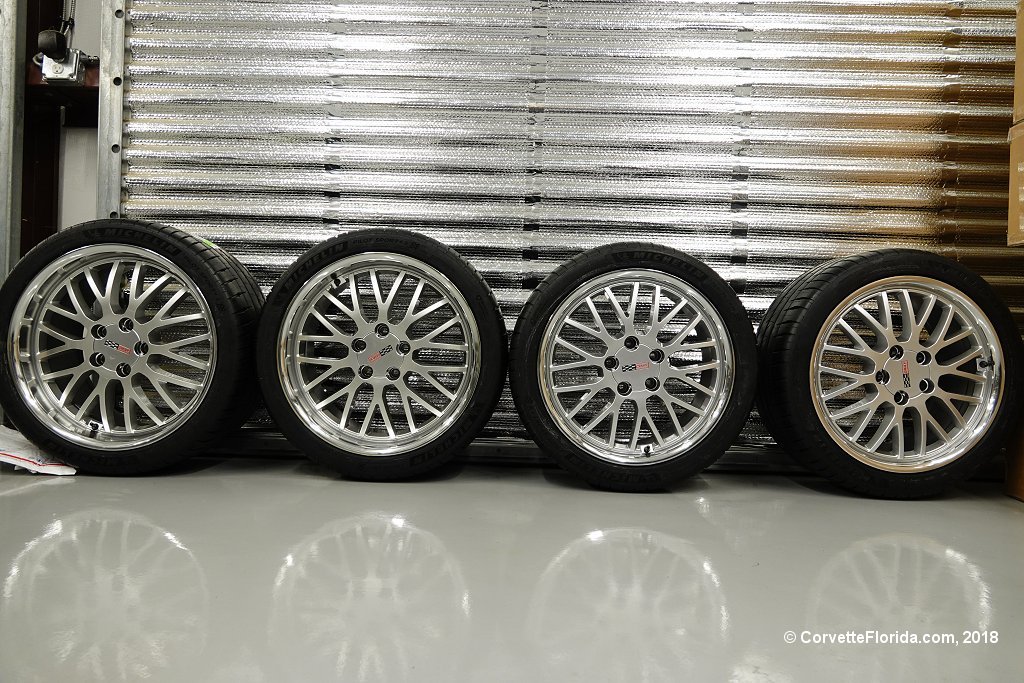

So, after looking at so many options it was making my head spin, I finally settled on ordering the following:
2 - 18X9 CRAY MANTA HYPER SILVER W/ MIRROR CUT LIP wheels
2 - 19X10.5 CRAY MANTA HYPER SILVER W/ MIRROR CUT LIP wheels
2 - 265/35/18 MICHELIN PILOT SPORT 4S tires
2 - 295/30/19 MICHELIN PILOT SPORT 4S tires
Mounted and balanced with free shipping from ElementWheels.com in Arizona.
They didn't have the 295s in stock, so I should have everything delivered by the end of the month.

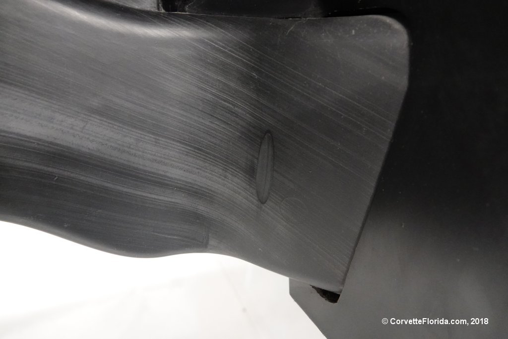

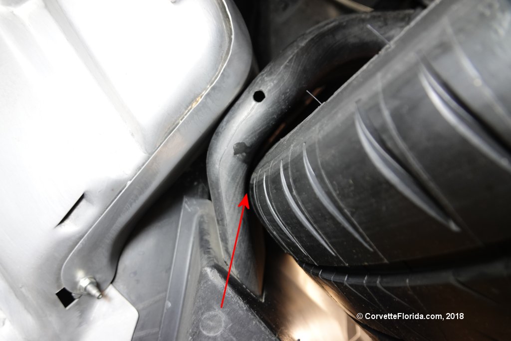

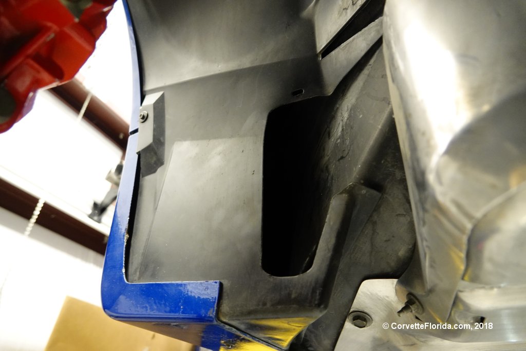

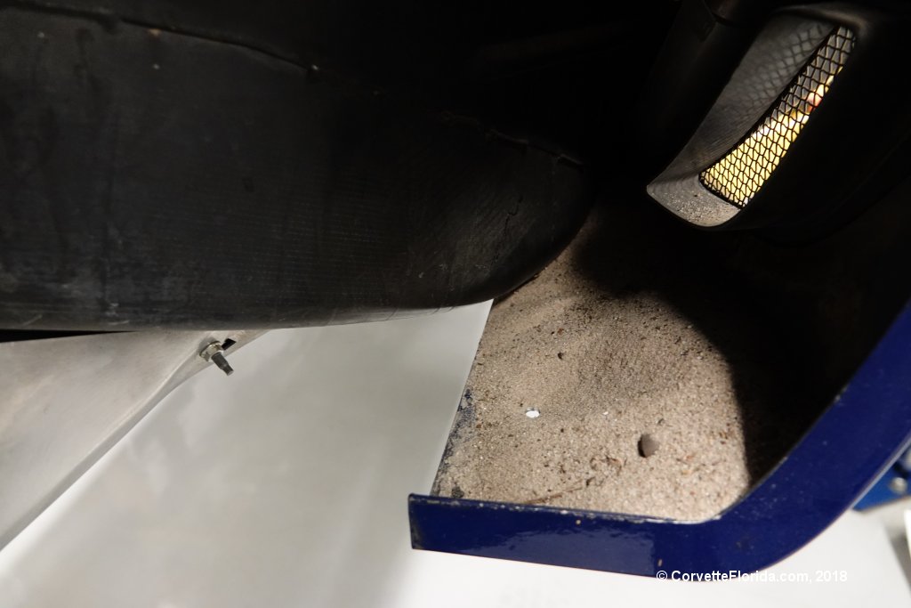

The reason I was looking this up is because I'm not exactly sure the rear wheels in this setup I ordered are going to clear those rear brake cooling ducts on the C5Z. If my calculations are correct concerning the backspacing of the new wheels, it appears the wheels/tires in the rear will be moved 0.75 inches closer into the wheelwell. I need to put the car up on the lift and measure what that clearance is right now with the stock wheels, but I don't think there is much clearance there at all, from what I remember. Cray's website says the wheels are compatible with the Z06, but heck, I've had "experts" work on my car before that proved to be disappointing with their "expertise". So I'm not much the trusting type any longer.
