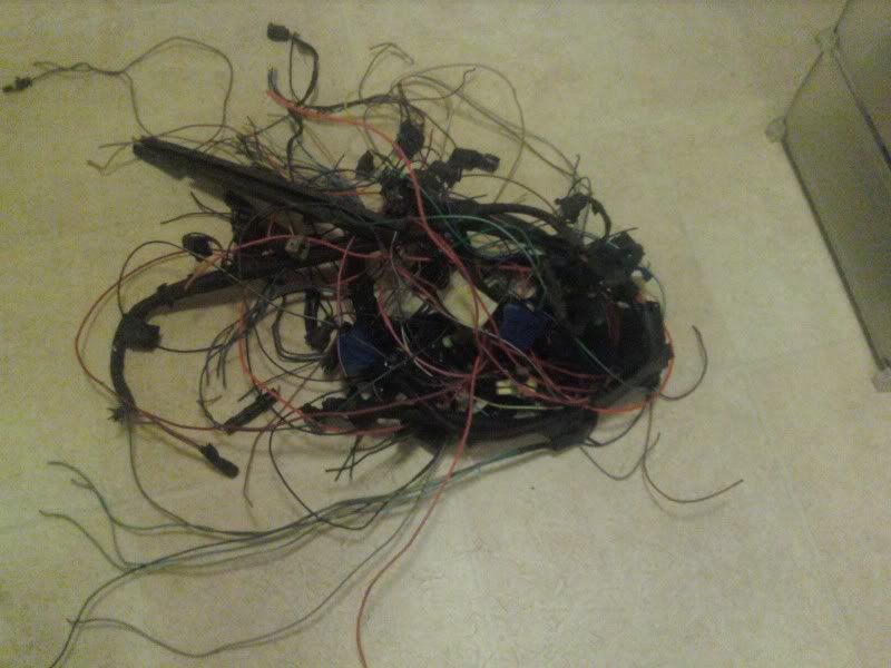

It's been awhile since I updated this, I've been busy waiting on parts and working on it when the parts are here. I now have to engine and trans in with the C-beam modded to work with it (I had to enlongate the holes) Shifter, headers and most of the wiring harness are installed. I ran into a small issue with the fuel lines but Greg at AntiVenom is hooking me up with a dual feed fuel rail so I have to remove what I have and reinstall all of that again. I just got my trans lines made up and my old harness cut down to what I think I'm going to need. It's getting close, hopefully it will run someday.:D
Here's the harness I just finished up last night.
This is the old harness when I took it from the car:
Here it is all cut and reloomed.
And here is the mess of extras I hope I won't need.:crazy03:

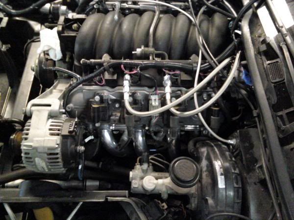

Here is a pic of how it sits now, getting close:

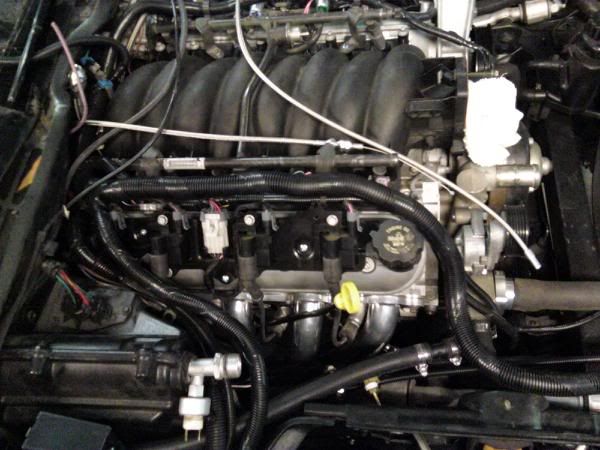

I picked up my dual feed fuel rail yesterday so I got out there today and swapped it onto the motor. I was then able to set my coilpacks. As it turns out the dual feed rail interferes with the coilpacks so I made some brackets that bolted to the valvecover then the coilpack bracket bolted to them. I got my alt too so all that is done now.
ON the pass. side somehow the coilpack brackets bolted right on no problem but I have all my wiring on that side so while it's busy looking it's all clean and routed well. I still have to make a bracket to bolt the fuse box too, mount the computer, get my throttle body and work out my upper rad. hose and air intake. It's getting close.
Oh yea, the stock L-98 rad. hose with a cut in the right place works perfectly for the LS.:thumbsup:
