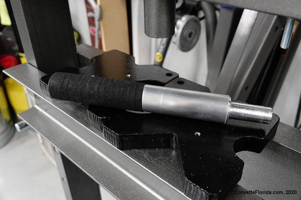

Next, I didn't want to have to use that long handle for the pneumatic press itself, as it would just wear you out if you had to use it much. So I had some 1.5 inch aluminum rod stock that I turned down on my mini lathe and made a shorter handle to work with.
I made the turned down insert end tapered so that the handle fits in there pretty snugly, and I can pretty much just keep the handle in place as I am working with the press. Also covered the grip with a cloth tape I had laying around that seems to work well. I considered knurling the handle, but I thought that would wear on the skin of my hands after a while. That cloth wrap is a whole lot more comfortable feeling. I don't imagine I would need the long handle for more leverage for most things I am likely to use the press for.
