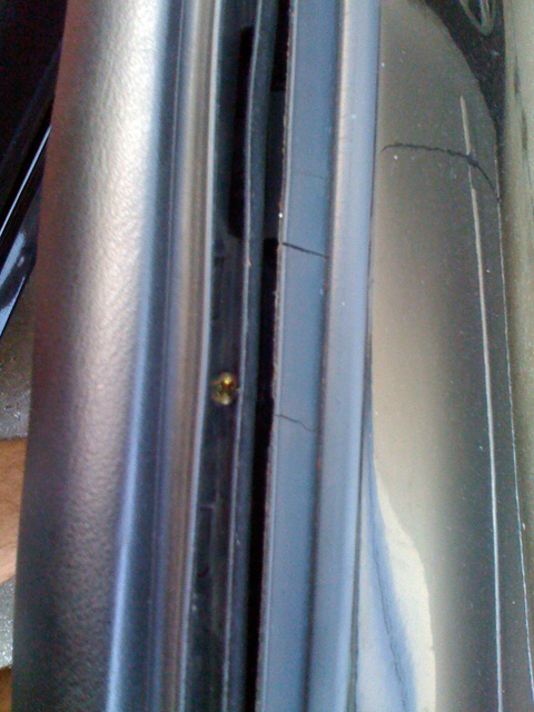

There is a great fix for this. There are two places you can screw the panel to the top of the door. The screws will be totally hidden unless you look down into the door panel when the window is down. I'll try to remember to take pics of mine when I get a chance. The only draw back that I found, is if your window motor happens to go out it's a nightmare to get the screws out with the window up so you can pull the panel off. It's doable though...

Yep, two screws at the top of each panel. You can't see it and works like a champ. GM should have thought of this in the first stinking place. I should have time to take a few shots after work today.
Sorry, I totally forgot. Now I've got my camera, but the vette is at home. Writing note now to remember to take a couple of shots when I get home.
Ok I finally took some pics. The first photo is the passenger door panel with screws installed. good luck finding them. The next two photos I highlighted the screws so you can see their placement. John over at AutoXTC actually did this for me while the car was in the shop for something else. It's the little things they do that make them a great shop. I've since had to take the panels off and screws are easy to remove and reinstall. :thumbsup:

Wow, I really need to replace my outer window edge. It's sitting at the house...I guess I have another project this weekend. :thumbsup:
They pretty much just screw right into the top of the inner door. I suggest taking the door panels off to find the best place for your car. Then make a light mark on the door panel, pre-drill with a small drill bit, reinstall the door panel, drill hole into door, then install screws. It's best to have two people as well as to make sure the door panel is straight and secured properly. Take your time and it'll look factory fresh and no one else will know any better.
