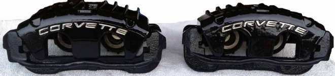

Swapped out the front calipers today. Get those painted and install them on the rear.

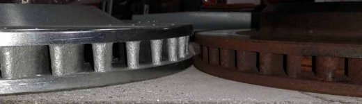

some pictures of the rotor differences
