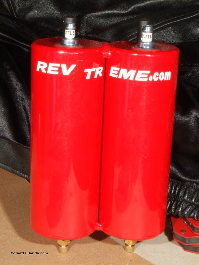

The purpose of a proper oil separating catch can is to route these gasses through a baffle system that provides the most contact possible with the outer surface resulting in the oil being trapped and removed from the other gasses that do continue on through the intake and are burnt and consumed. It does NOTHING else in ANY way to the engine oil itself....it can't.

Now, addressing the "Home Depot" oil separator, it will and does catch a small amount of the oil but the majority still gets past into the intake (we used these and then the other cans that popped up on the market through the years before designing the ultimate final product that is offered today) and the reasons are simple:
It is plastic and transfers heat very inefficiently so very little condensing takes place.
The size. Anything less than 1 qt capacity and there is not enough surface area to be as functional.
And the lack of an effective baffle system allow oil to be pulled directly through.
As for having steel wool or another type of filter media inside, this will work well at first to trap oil....but as soon as it gets saturated droplets are pulled off and into the intake.
Why don't the auto manufacturers incorporate something similar? Cost and the added maintenance was deemed something that would NOT be accepted by the general market. (even though it is as simple as draining the can at each oil change).
The RevXtreme oil separating can is the best functioning can on the market and is easy to test against any other. Simply install a clear inline fuel filter between the outlet of any can & the intake manifold, you will see some saturation of the filter element with most any other, and as long as long as there are not internal engine issues, the RevX can will show little if any getting through, as it has a unique design with a perforated dispersion tube running down the center of the can from the inlet that results in the most complete dispersal possible for condensing the vapor/mist to droplets where it is trapped to be drained later. What makes the RevXtreme can even better is additional internal baffling consisting of discs that channel the exiting gasses one last time along the outer surface before entering a separate channel that keeps the trapped oil in the main portion of the can and a integrated PCV check valve that controls the amount of vacuum pulled and prevents "back-flow" or reversion back to the crankcase.
