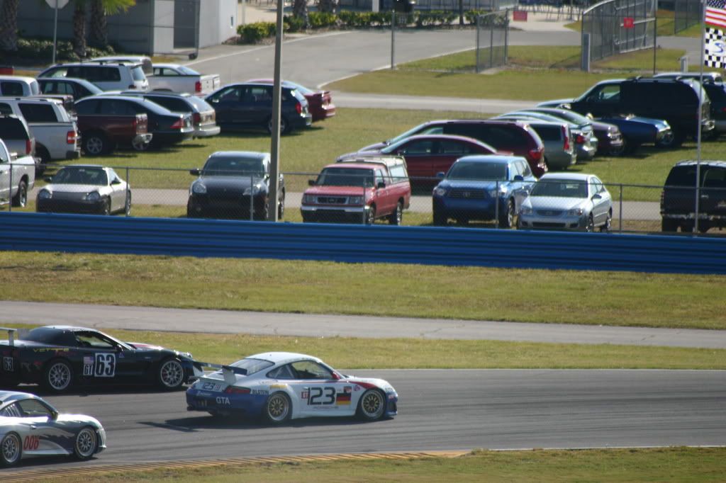

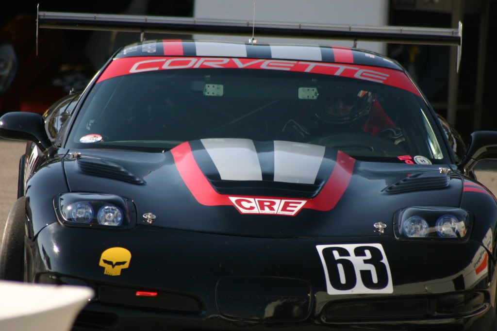

After spending a year and a half on it, we finally hit the track this past weekend. Here are some pics from the HSR event held at the Daytona International Speedway.
Great Corvette
Awesome pics guys.....Awesome Corvette!!
Can you give us anymore info on the car....HP, Engine, Mods, etc.
Thanks
:D Jim :D
I honestly can't tell what the top speed was, Neal was driving and I was crew chiefing, since this was our first run we were kinda busy just making sure we ran the entire race. We developed a miss that was driving us nuts over the weekend, we said before we ever went that if we finished in one piece that we would consider it a successful trip. Beside I didn't set up my AIM timing beacon and my telemitry system wasn't set up to work off of the scoring loops. Like I said we just wanted to put the car through a good shake down.
The car is pulling 468 RWHP, there is more there but we`want to stay on the safe side. It has headers, a head and cam job, 90 mm TB and intake, coilovers, R6 Hoosiers, stripped down as much as possible except for the roll cage and safety equipment, plus a World Challenge aero package.

I really like the stripes.. reminds me of the '04 Z06 Commemorative version that I have.
Downloaded the telemitry this past weekend, evidently there was an AIM timing beacon setup; anyway looks like as bad as it was running we still hit 156. Fuel pump wiring was the issue, I think it is taken care of now. Next race will be Sebring the first weekend in March. The 2008 schedule is available ar www.hsrrace.com :wavey:
