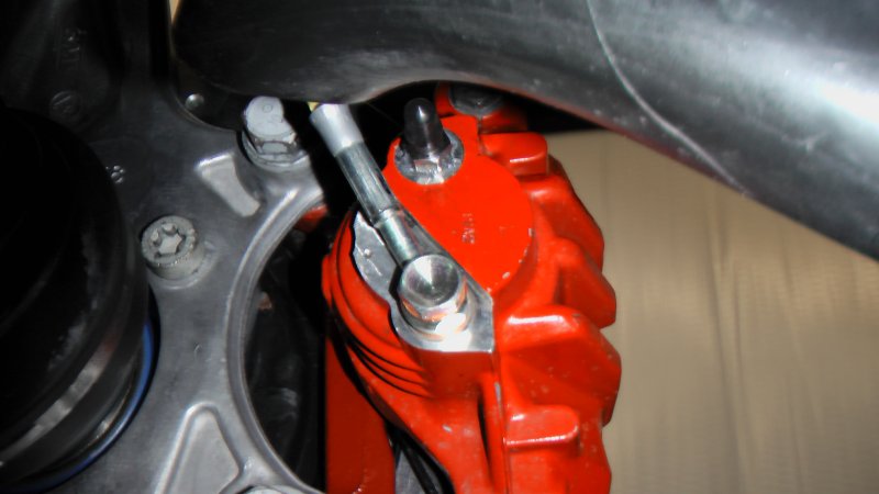

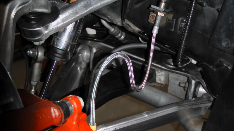

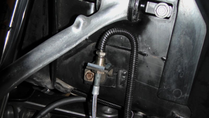

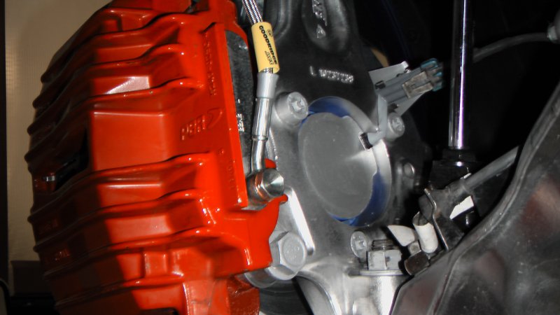

Yesterday and today, I put on the stainless braided brake lines and flushed the brake fluid. I used the blue ATE brake fluid, as that made it much easier to tell when new fluid had gotten through the calipers and out the bleeders. Oh yeah, I replaced the bleeder screws with new stainless ones while I was at it.
Here's a video of the Motive brake bleeder tool I used to bleed the brakes:
Now, I did it a little differently than they recommended, in that I didn't fill the tank up with brake fluid, but only filled the master cylinder reservoir and only used the tank to apply air pressure. I just checked the master cylinder reservoir after every wheel, and topped it off as needed, and that worked just fine. Plus I didn't have to clean up the brake fluid residue in that pressure tank afterwards that way. Just pumped up the pressure to around 17 psi, then put a drain hose on the bleeder, and opened it up till I saw all the air bubbles go away and the fluid change color. Easy peasy..... :thumbsup:
I was actually surprised at how quickly the new fluid got to even the rear calipers. And I only used about three quarters of a can (I think it's a quart can) to do all of the calipers. The instructions tell you to put two quarts in the pressure tank, so you would certainly waste a lot that way. Once you open up a container of brake fluid, anything you don't use right then and there, you throw away.
