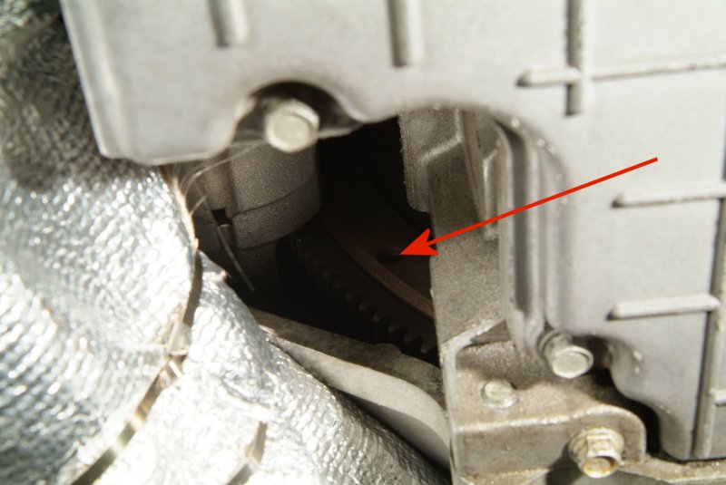

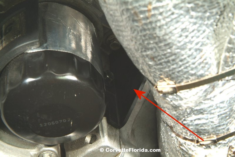

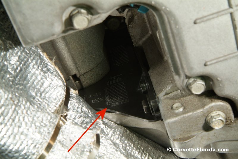

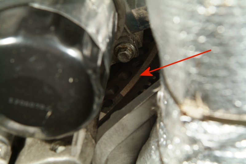

Speaking of which, a little while back I had the C6Z up on the lift and I noticed that there are some sort of covers on the bellhousing that appear to be dust covers for the flywheel. You can see them looking from the front of the car towards the rear, underneath, of course, attaching to either the block of the lower edges of the bellhousing. These are not present on my C5Z. So I took a couple of photos and sent them to Gene Culley to see if he can get them for me.
Here's the driver's side:
And here's the passenger side:
I'm wondering if what I am hearing is some junk getting between the flywheel and clutch pressure plate making that intermittent squealing noise. I live on a sandy road, and even though I drive REAL slow down it, certainly the front tires are kicking up sand and without those covers in place, maybe sand is getting in there. But in any event, I would guess having those dust covers in place would be a real good idea.
No telling where the originals wound up at. But I do know they were not there when I brought the car home from Aaron Scott's shop. Certainly they might not have been there after leaving Chris Harwood's place. :shrug01:
I don't know about Vettes but on a Ford they make a separator plate that goes on the back of the block, before the flywheel is installed, it is held in place when the bell housing is bolted to the block.
It is two separate bolt on pieces on the vettes. Apparently held in place by a single bolt, as Gene is getting me the two bolts I will need as well.

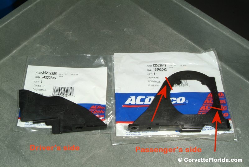

Got the bell housing dust covers in today from Gene:
Notice that hole in the one on the passenger side? That's for the starter. So obviously it's to be put into place while the starter is out, so the starter can go THROUGH that hole to engage the flywheel. Also obvious is I sure as heck didn't want to pull the header off that side of the engine to get to the starter, so I had to improvise. What I did was to cut that dust cover at the lines I marked in red. Fortunately they are only made of plastic, so it was very easy to cut it until I got it to fit. So it doesn't go all the way around the starter, but it certainly will help to keep most of the junk from flying up into the bell housing while I am driving.
And, btw, it takes three bolts total for these things. Two on the passenger side, and one on the driver side. I only got two with them, but fortunately one of the screw, nut, and fastener kits I bought had a bunch of the correctly threaded and sized bolts included.
I kind of doubt that stuff blowing up into the bell housing was causing the drivetrain noise I've been hearing, but at least I feel better knowing those covers are in place now.

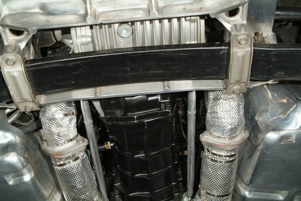

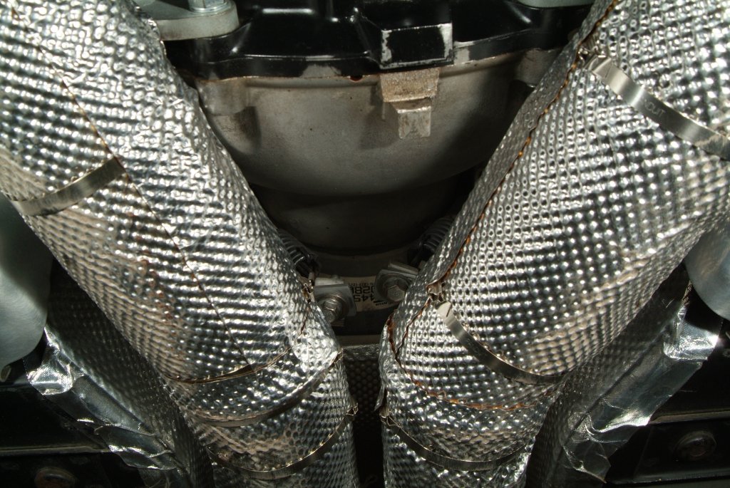

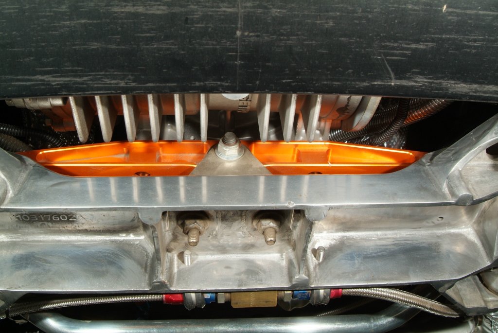

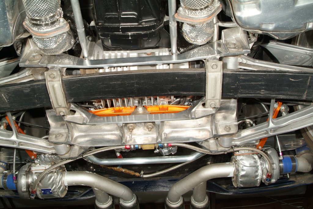

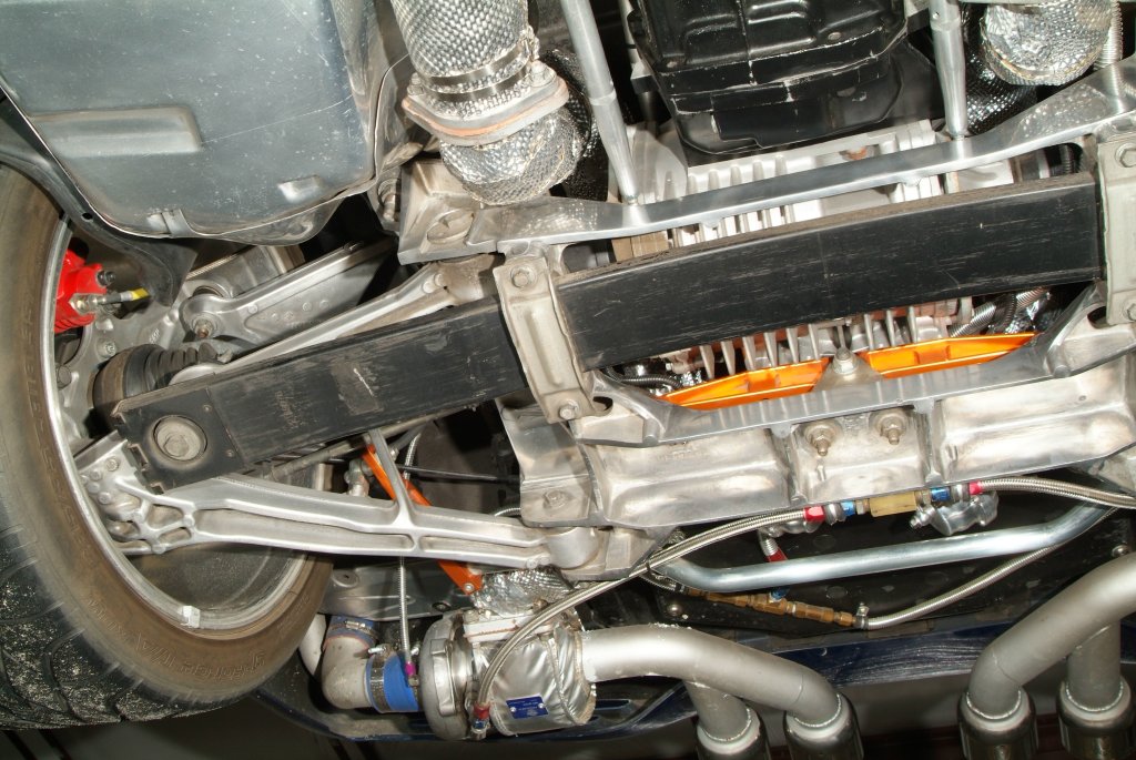

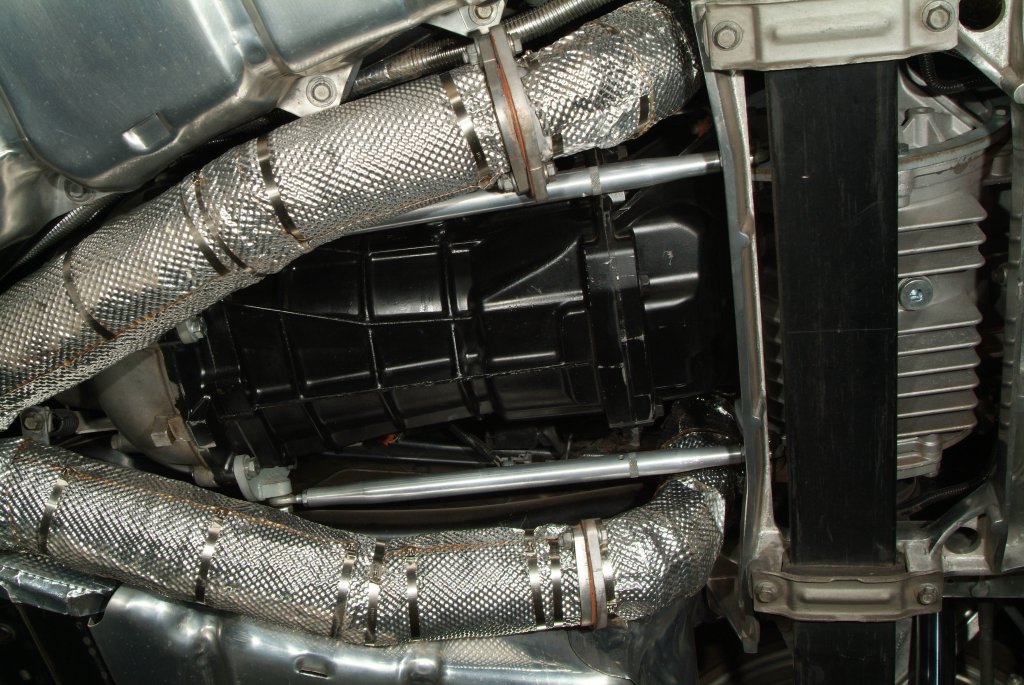

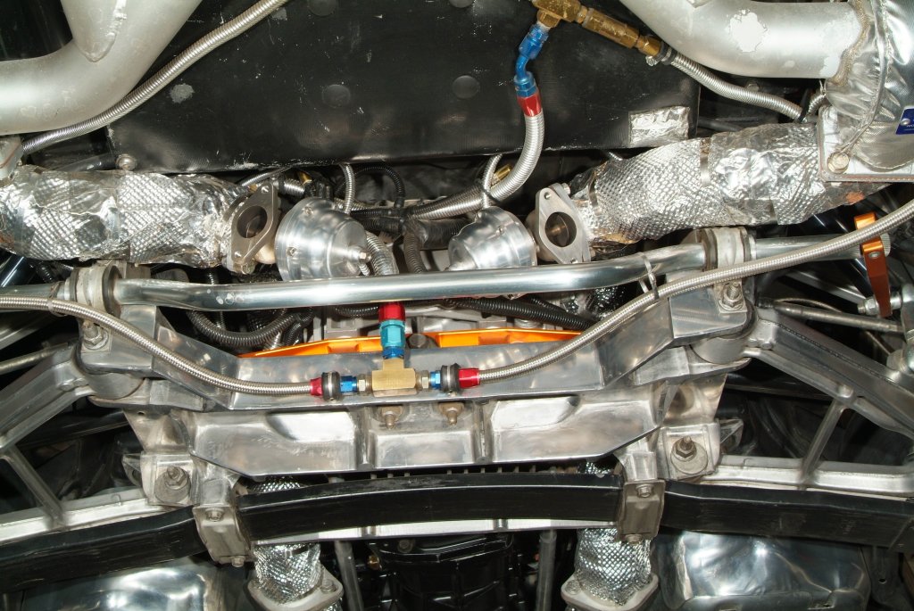

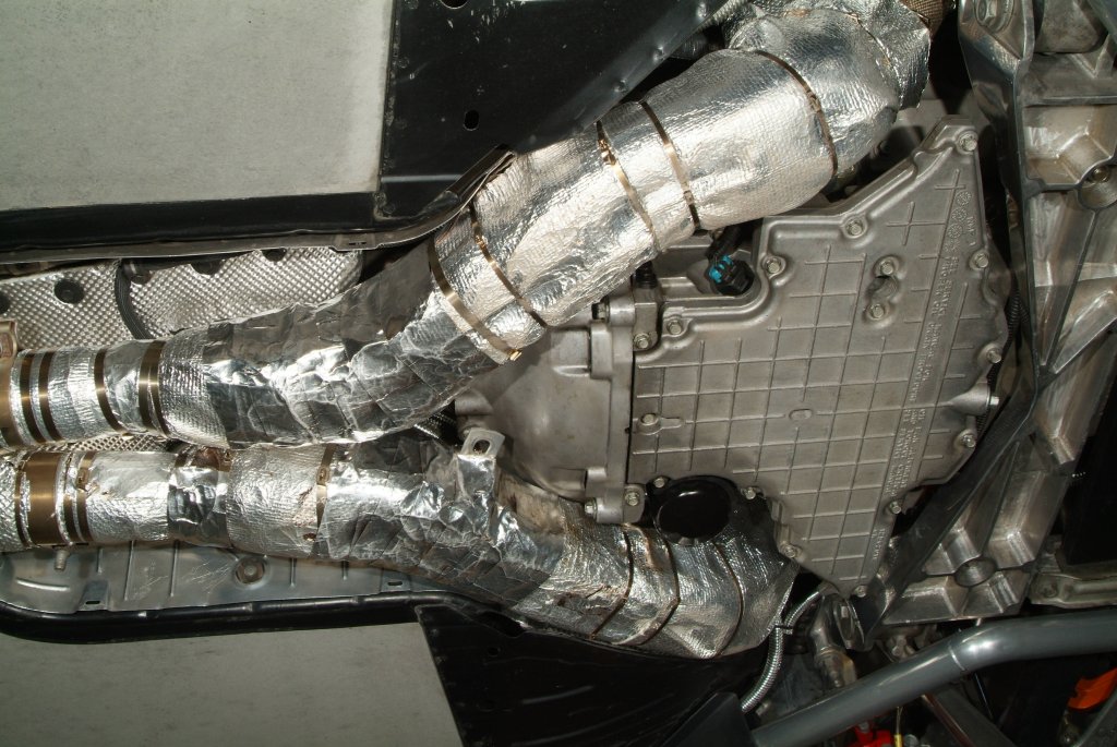

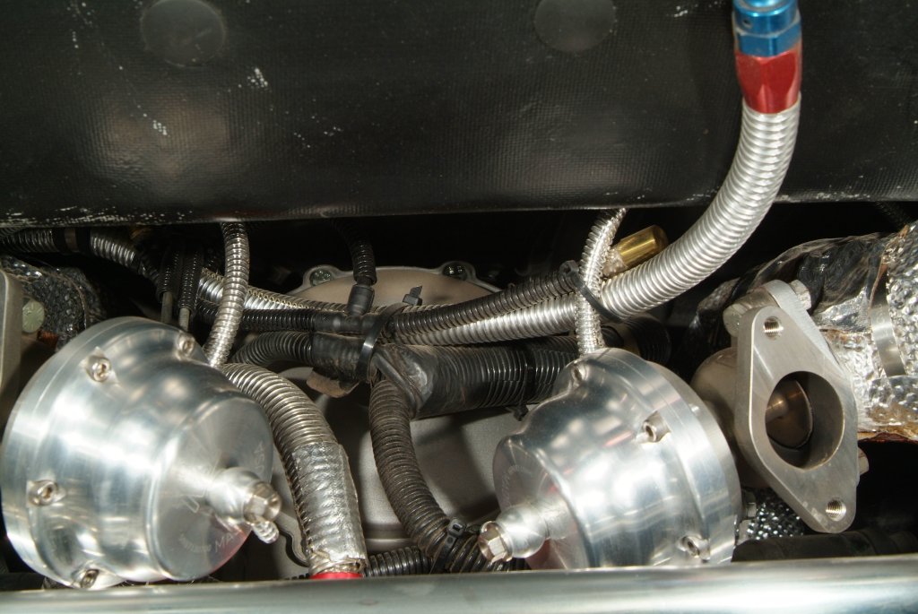

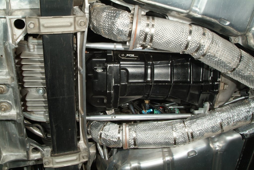

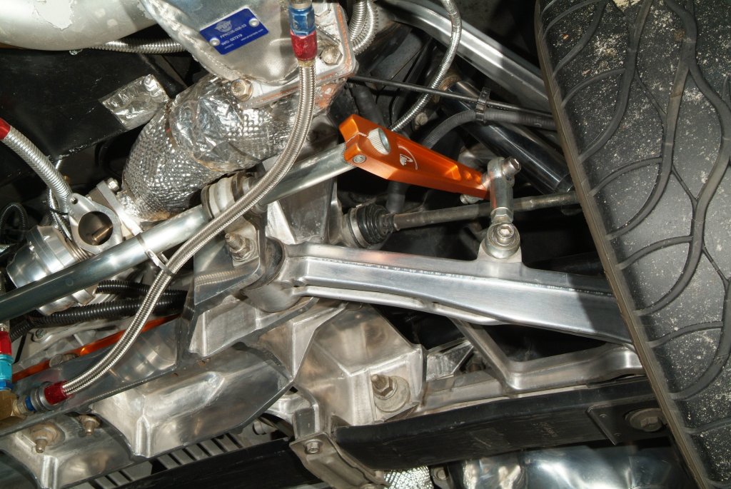

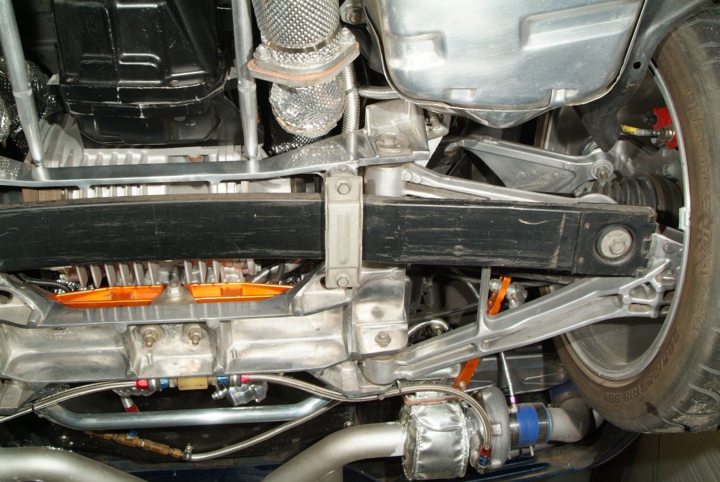

While I was thinking I was going to be pulling out the drivetrain, I went and took a bunch of photos so I could reference them when I may need to. Guess I might as well store them here.
