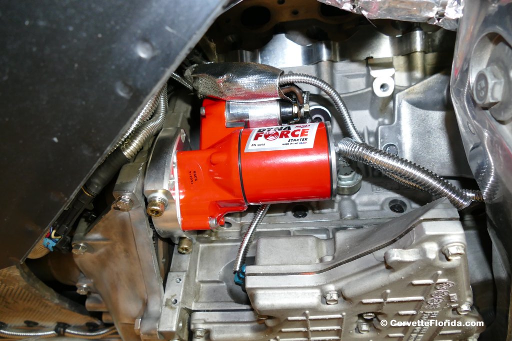

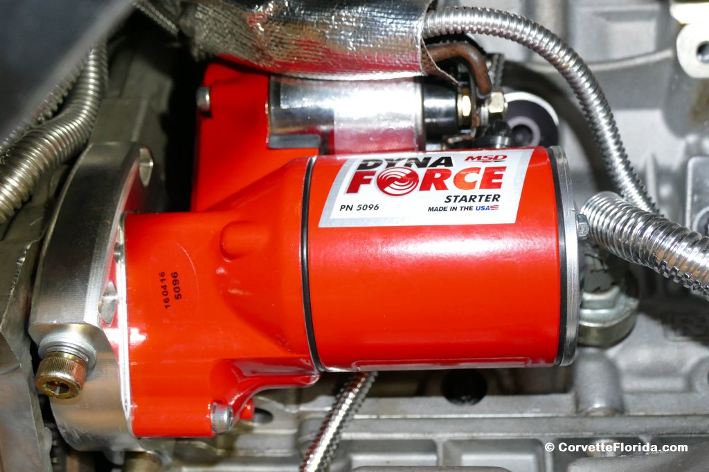

Got the new MSD stater installed.

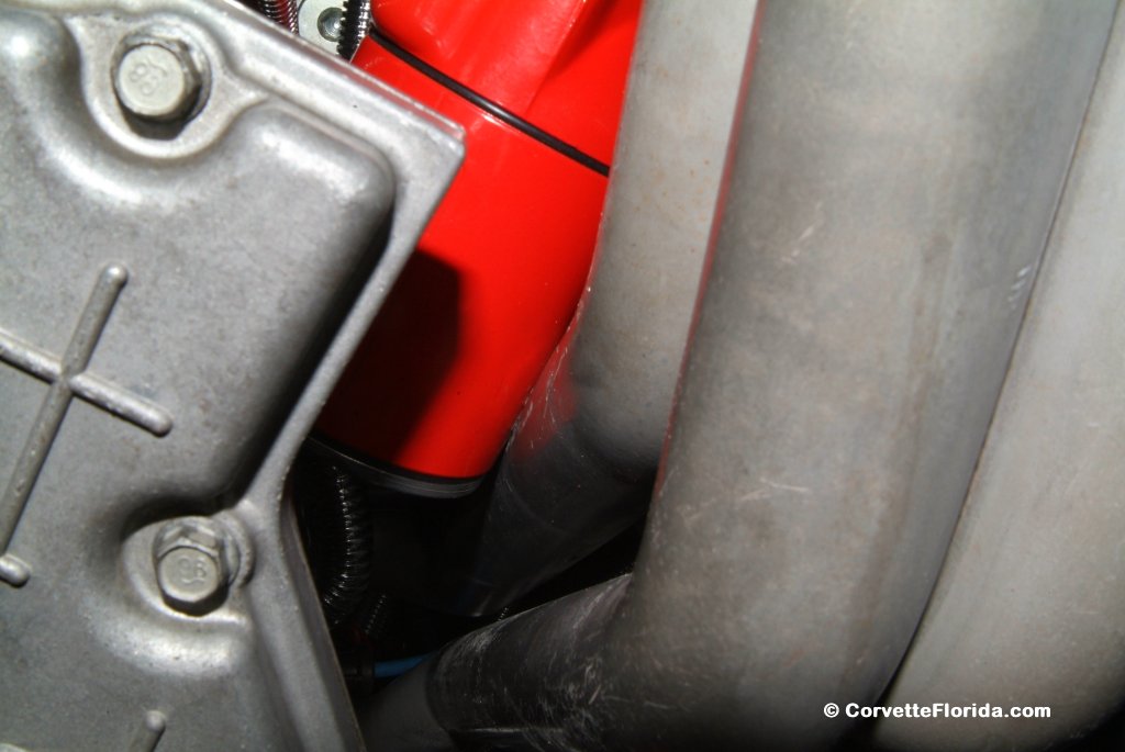

I found out that this starter is slightly wider than the stock starter, so the passenger side header will no longer just slip in and out. I had to remove the mounting bolts to get the header back in.
I tested the starter before putting the header back in, and I think I like the sound of the MSD better than the stock starter. I torqued the nuts on the solenoid studs down to the specs I found. 11 ft/lbs for the large nut holding the hot wire from the battery, and 37 inch/lbs for the small terminal from the ignition switch. The install instructions from MSD didn't say anything about torque specs for the electrical stuff, but the mounting bolts they listed as 32 ft/lbs to torque them down. I also put nord-lock washers on them to keep them from coming loose anytime soon.

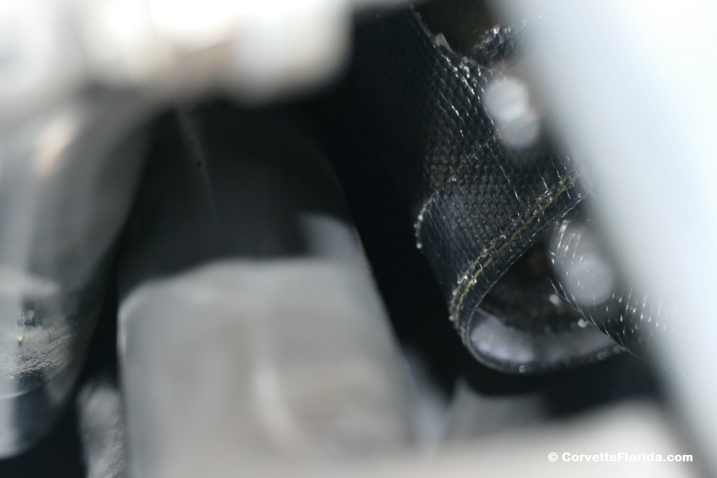

Yeah, I got the car all back together again, but when I was checking for anything laying against the passenger side header, yep I found something. The new MSD starter was laying against one of the primary tubes.
Now being close is one thing, but I seriously doubt it would bode well for longevity of that starter with a header tube laying right up against it. The heat from the header would be directly transferred to that starter body. Not to mention that the header tube was pushing against the unsupported end of the starter, so how much stress is being applied to the bolts holding the starter to the block? That can't be good.
Being a firm believer in Murphy's Law, I started sweating it. The entire reason I was doing all this starter crap was because of the slight chance of the stock starter breaking the thin mounting flange, and then the thicker flange taking out the part of the block it attached to. So I went through a Powermaster starter that the wiring would not attach to. Then the nut on the positive battery cable running to the starter solenoid loosened up. Now the MSD starter just won't fit without it's own issues. Was this going to be the third strike if I did a "let's see if it works ok"? Wouldn't that have been a pisser if THAT broke the starter mounting area on the block? Murphy works like that.
I did notice that when I was putting everything together that I could not slide that LG Motorsports Pro long tube header into place like I could with the stock starter. I had to actually remove the starter mounting bolts to get the header back in again, unlike with the stock starter. I didn't feel that was any big deal. Not until I discovered that the MSD starter had to be considerably thicker across in order to have the header tube actually touching it. So that also explained why the header wouldn't slide in place like it should have.

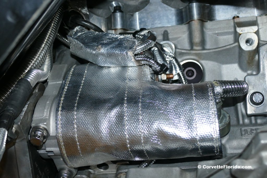

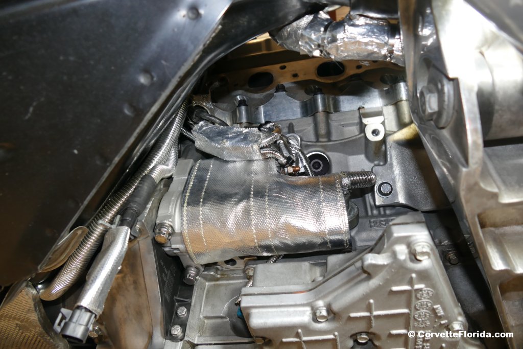

So I got the ACDELCO starter back in. I sure have gotten a whole lot of experience replacing starters in a very short time.

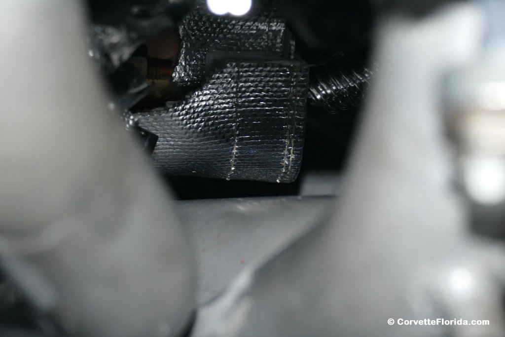

Got it wrapped up with a heat shield all nice and purty. I checked the clearance between this starter and the primary header tube and there is a good 3/4s of an inch clearance there. So that MSD starter is quite a bit larger in diameter than the stock starter is.
I can't believe that I haven't read ANYTHING about anyone else having clearance problems between the MSD starter and headers. Even with brands other than LG Motorsports, I can't imagine that there is going to be that much difference in clearance issues around the starter. There really just isn't a whole lot of room to play with there. And looking at this from another angle, I can't believe that MSD wouldn't have designed the starter with headers taken into consideration. What's the chances that someone would put in an aftermarket starter and NOT also have headers in their car?
The passenger side header went in very easily with the ACDELCO starter in place, so that is in and all bolted up now. Connie helped me by holding up the tail end of the header while I got the bolts starter. I think she likes being on the creeper underneath the car. She says it feels cozy there. I had the car on the lift just high enough for her to get under the car, which stands underneath the lift arms for safety. Then I had to put a step stool next to the engine compartment so I could reach in and get to the header bolts. Awkward, but doable.

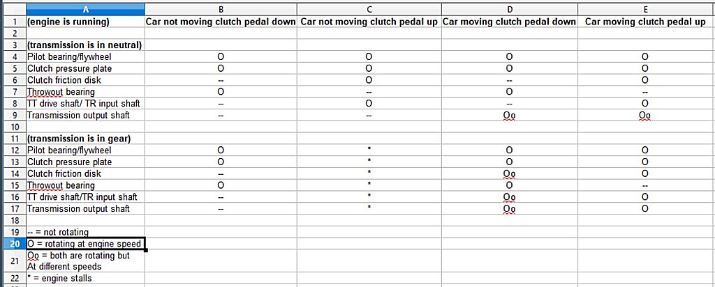

I'm still trying to get my mind straight about what potentially could be causing this drivetrain noise I'm having, so I decided to set up a chart that would show me what parts are rotating and which ones are not under particular circumstances.
The idea being that likely the noise I am hearing is coming from a part that is rotating pressed against a part that is not rotating. Or in a transition stage from a rotating part pressed against a non-rotating part to make the non-rotating part rotate.
In my case, the noise is most prevalent, although intermittent, when the car begins to move from a dead stop with me lifting up on the clutch pedal which brings the clutch pressure plate in contact with the clutch disk and presses it against the flywheel. A complication here is that it seems that the drivetrain has to actually be under load for that noise to appear. Working the clutch while the transmission is out of gear never seems to make the noise appear, whether the car is moving or not. In the video I did earlier, just the load of applying force to the rear wheels seemed sufficient to make the noise evident. Sometimes.
So there appears to be several components that are mechanically tied together and act as one concerning their rotation.
They are:
  1. Pilot bearing, flywheel, and clutch pressure plate.
  2. Clutch disk, torque tube input shaft, torque tube driveshaft, torque tube output shaft, and transmission input shaft
  3. Throwout bearing
  4. Transmission output shaft, differential, rear wheels
#1 is tied to engine speed. If the engine is running, those parts are rotating.
#2 is tied together as a single unit, effectively. If one part is rotating, they are all rotating.
#3 is only rotating when the clutch pedal is down, pressing it against the fingers of the rotating clutch pressure plate.
#4 is only rotating if the car is actually in motion, as they are tied to the rear wheels. So if the car is moving, they are all moving.
So the three conditions to be considered with all these moving parts are:
  1. Is the car moving or stationary?
  2. Is the transmission in gear or not in gear?
  3. Is the clutch pedal up or down?
So when I am hearing the drivetrain noise, the car is stationary, the transmission is in gear, and I am in the process of lifting up on the clutch pedal to bring the clutch pressure plate against the clutch disk, which begins to impart rotational energy through the torque tube input shaft, through the driveshaft to the torque tube output shaft, into the transmission input shaft, through the transmission output shaft to the differential, and then to the rear wheels.
Until I begin to release pressure on the clutch pedal to engage the clutch pressure plate against the clutch disk, there is no noticeable noise anywhere that I have noticed. When the car is sitting still in idle with the clutch pressed down, transmission in gear or out of gear, there is no noise. When the clutch pedal is fully released in the up position with the transmission out of gear and the car not moving, there is no noise. When the car is moving with the clutch pedal up or down, transmission in gear or out, there is no noise.
The ONLY time there is drivetrain noise is when the clutch pedal is in transition from being fully down to fully up with the transmission in gear. And sometimes I can hear a faint squeal and feel a shudder in the shifter during gear shifts. Again, highly intermittent, and only in the process of the clutch pedal being lifted after the gear shift change.
Today I took the car out to test an idea I had. What I wanted to do was to run the car up to speed, and then leaving the transmission in gear, let off the gas pedal to bring the engine speed down to idle, then push in the clutch pedal to disengage the clutch pressure plate from the clutch disk. Therefore the car's speed would actually be high, but the engine speed would be at idle. That would have the drive train from the clutch disk back to the rear wheels spinning rapidly, yet the pilot bearing, flywheel, and clutch pressure plate would be only at idle speed. The idea was that if the pilot bearing were bad, then in this condition, with the torque tube input shaft spinning rapidly, if the pilot bearing were shot, I would hear a clatter or squealing as the nose of the input shaft rattled around in the bad pilot bearing. However, no such noise was evident when I tried that. I tried it a couple of times, just to be sure. So much for that idea.
Of course, the drivetrain noise didn't show up the entire time I was driving the car, so I'm not sure I really proved anything. But I would think with a positive solid failure of any of the above listed components, the noise would be constant, and easily reproduced on demand.
So what does this all mean? What it likely means is that when I have someone else look at this, that drivetrain noise will not be able to be reproduced, and whoever is looking at it for me will think I'm some kind of nut with an imagined problem.
