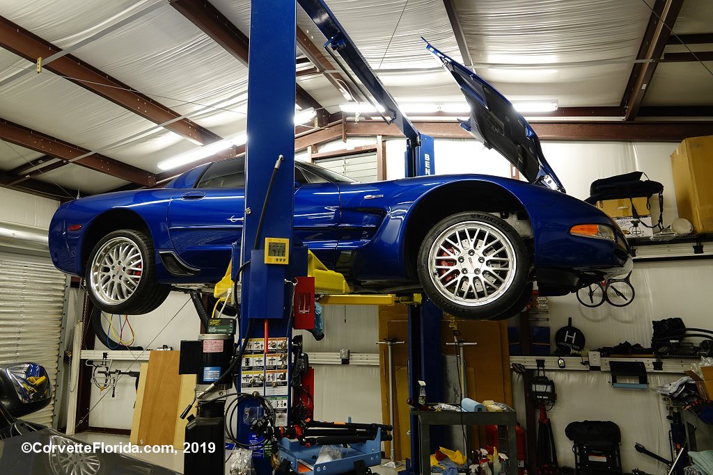

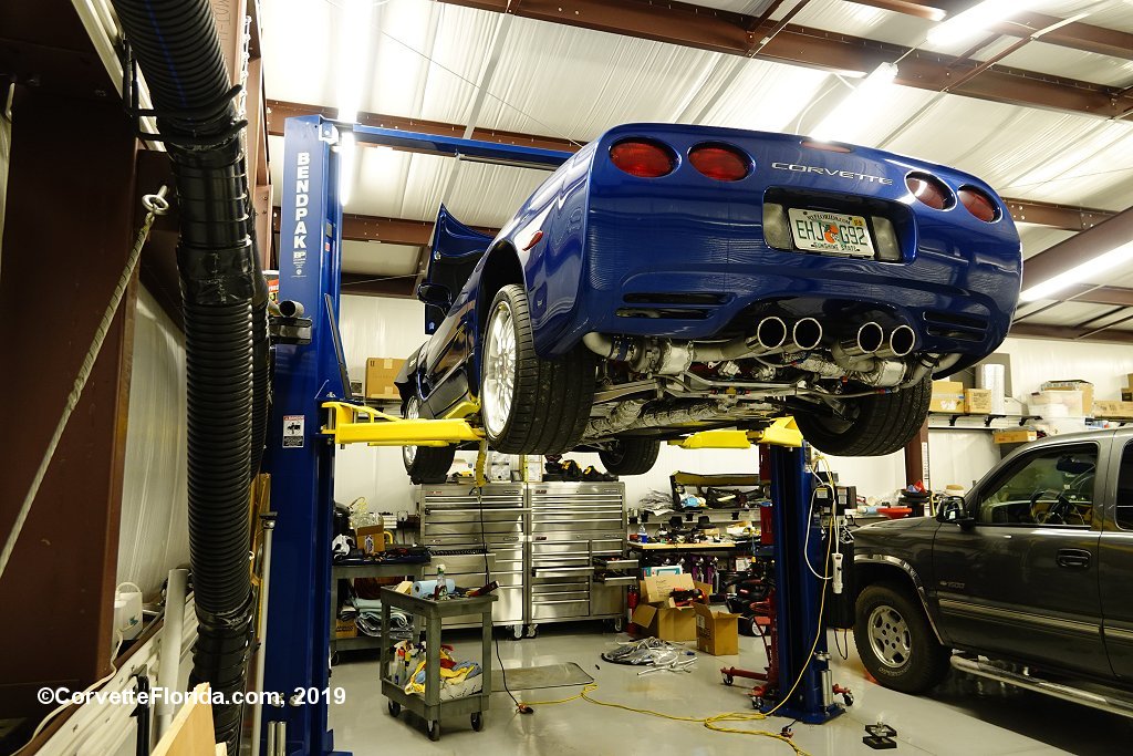

Found that the heat shield on the driver's side motor mount is not where it should be. It is facing frontwards, and the headers are in back of it, so the shield isn't doing a darn thing. Likely tomorrow I will see about lifting the engine up just enough so I can move the heat shield around to where it should be. Not sure why the tech didn't put it in correctly in the first place.
So it is going to be a couple of more days before I can just take it for a spin around the neighborhood.

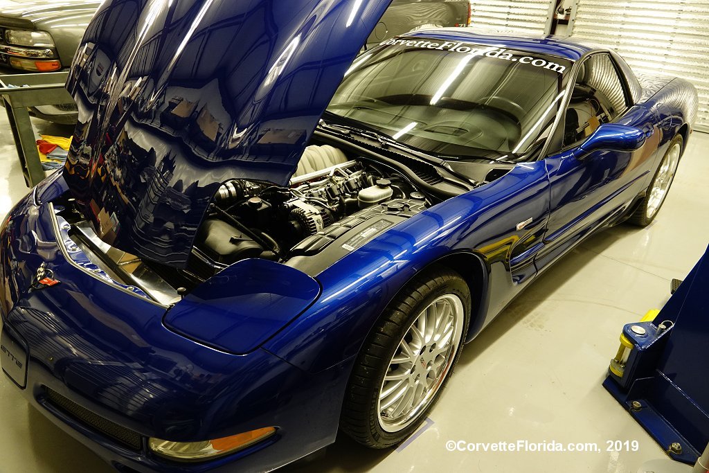

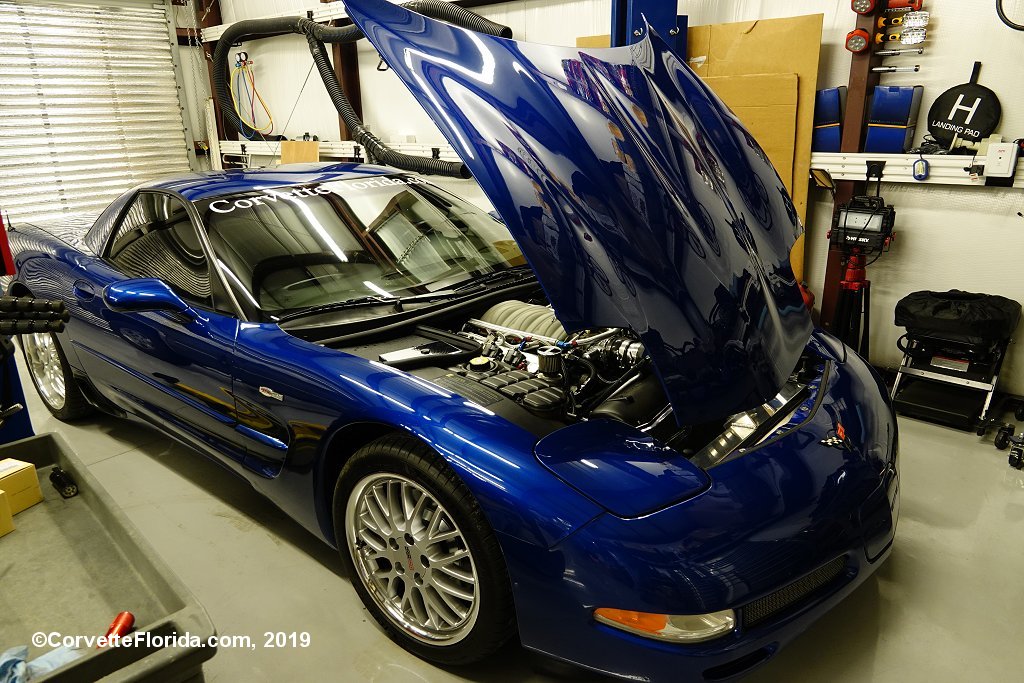

Might as well post pics of the C5Z being back where it seems to spend most of it's time.
