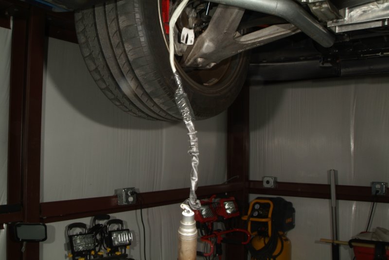

Got the exhaust system off the car up to the headers today. Replaced the O2 sensors and harnesses. One of the cats has a noticeable rattle to it, with the matrix core moving front to back when I tilt it. Probably not long for this world, but it looks OK visually on the inside. In any event, I have a pair of cat delete pipes coming in tomorrow. I want to take those catalytic converters out of the equation temporarily while getting everything else set up.

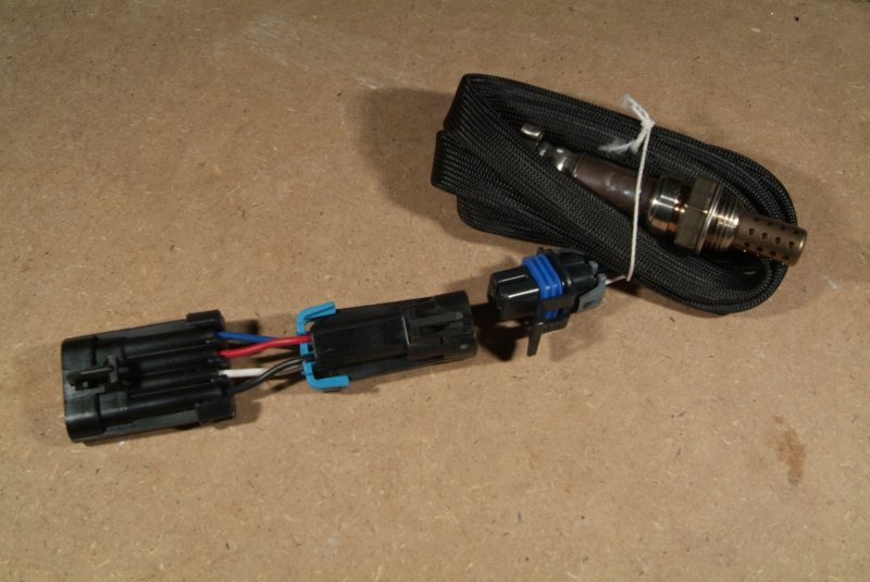

Oh, in case anyone is interested, here's what a rear O2 sensor and the needed adapter to mate it with the front harness.

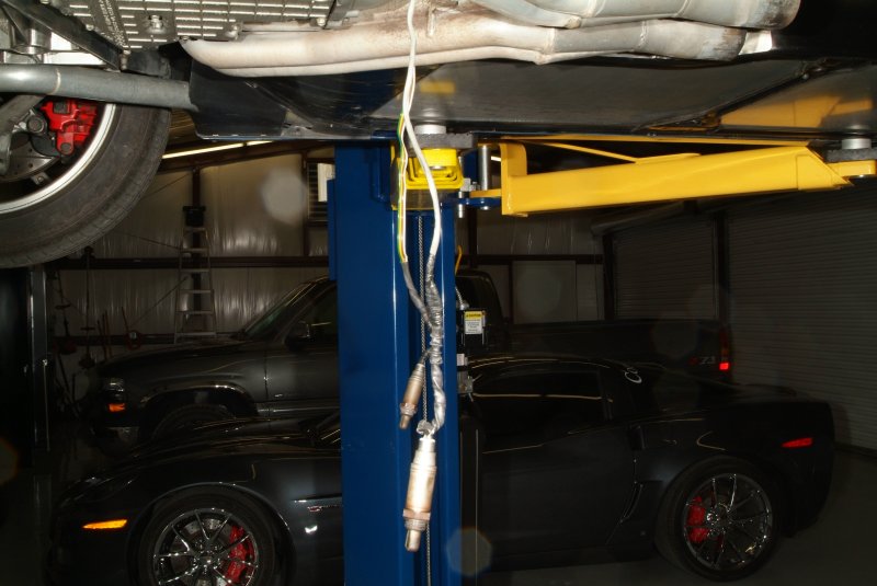

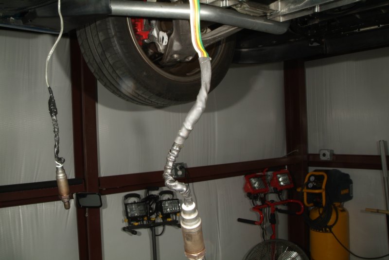

Here's some pics of the old sensors that I took out:

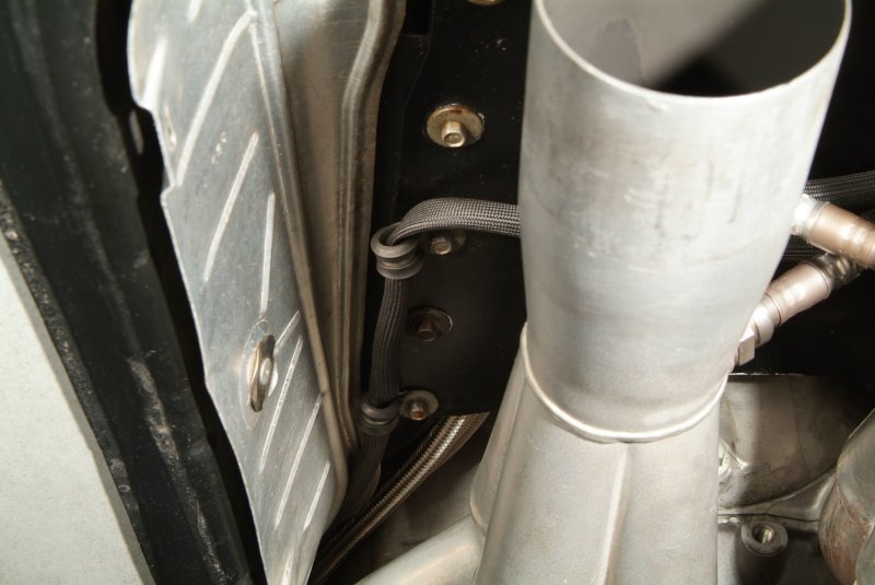

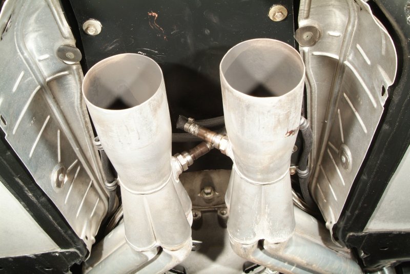

And here's what it looks like with the new sensors in with the way the harnesses SHOULD look:
Looks MUCH better Rich :thumbsup:!
Were either of the old ones cross threaded, did you have any trouble getting
them out, and any problems threading the new ones into the bungs?
Inquiring minds want to know..........
Andy :wavey:

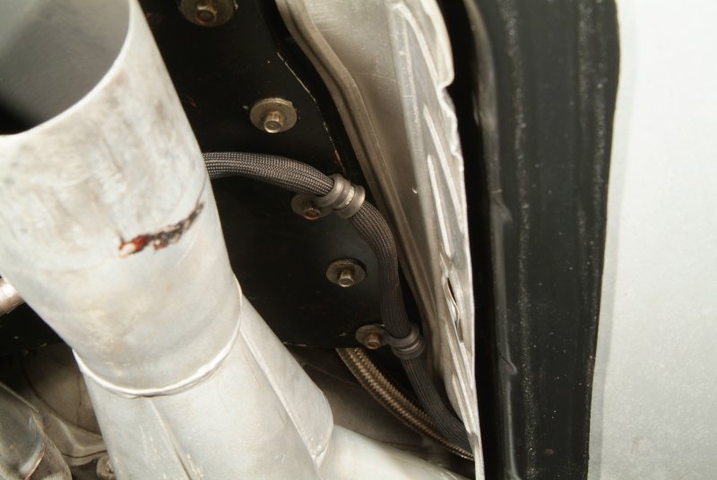

Took some video of a few problems I found while poking around underneath the car. I found one more rattle, it seems. The AC condenser is loose on the driver's side. Not sure what holds it in place, but I guess I'll find out.
Then I found that a screw was left off of the tunnel plate. Didn't notice it with the exhaust pipes in place.
I had run the car for a bit and noticed water splashing on the floor from one of the exhaust leaks I knew about on the driver's side. Then I saw another few drops coming down from the catback flange. Looks like the bolts just were not tightened sufficiently.
Also of note was that when I was trying to bang the cats off of the back of the crossover pipe, instead of them coming loose, the x-pipe itself pulled off of the headers. So apparently the clamps holding the x-pipe onto the headers were not tightened down neither...

Cats strata will break it hammered on or banged around. Can only be slipped on and clamped or the next ones will break as well. Dosent take alot to break the ceramic strata.
Yeah, I think I was living on borrowed time with them. All it would take is for one to break up and the turbo on that side would be history.

Would it be better to have the X-pipe directly after the headers, or have the cat delete pipes inbetween the two? Since I have unused plugged bungs on the X-pipe, I'll be able to use that when I get my wideband figured out. So there are two variables to consider: (1) In respect to the wideband, would it be better closer to the headers? And (2), does it make any difference performance wise where the X-pipe actually is located in the exhaust?
Oh yeah, I noticed that the pipe on the driver's side of the X-pipe is 1 inch longer than the other side. Is that normal?
