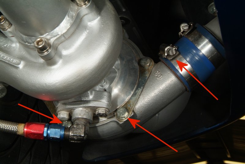

At one point I tried loosening up a clamp on the passenger side turbo that goes to the cold side air housing so I could get that side to drop down a little bit more. But when I did that, I started getting a real slow oil leak coming from the two bolts at the bottom of that housing. When I say "real slow" it's like two or three drops every several hours. But still, it IS an oil leak.
So I figured maybe those bolts were loose and tried to tighten them up a bit. Disconcertingly, they were loose, and would NOT tighten up, so apparently they are stripped in that aluminum housing. I moved the hose clamp back the way it was, and it appears to have stopped leaking. But I'll be checking it to make certain.
So, let's see, who was it exactly who last took apart those turbos? Oh yeah, Aaron Scott. :rolleyes:
If the oil leak stops, I'm just not going to worry about it. If not, well, I guess I need to figure out how to fix stripped threads in aluminum so I can fix that. :banghead:

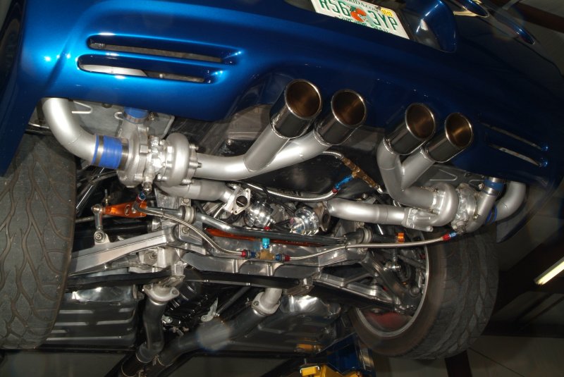

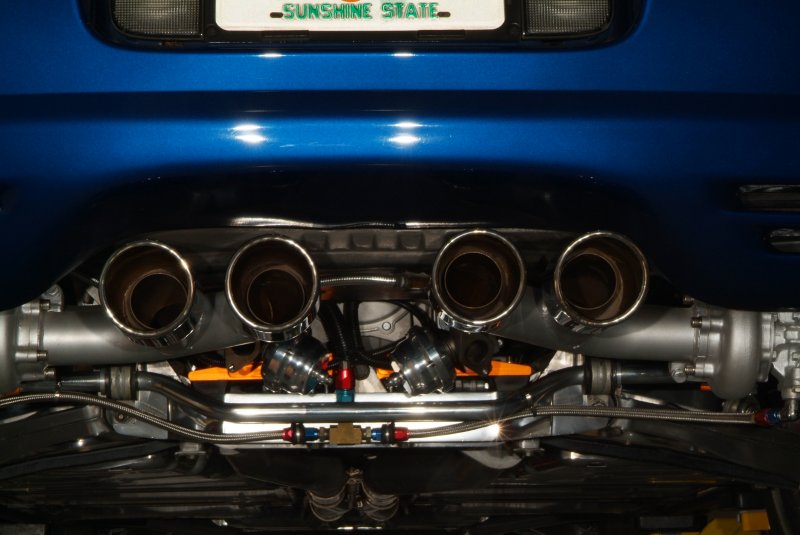

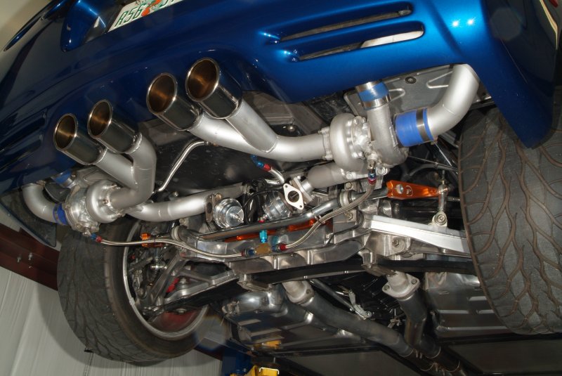

Anyway, I also took a couple of pics of the underside of the back of the car while I had my camera out and the car up there on the lift.
