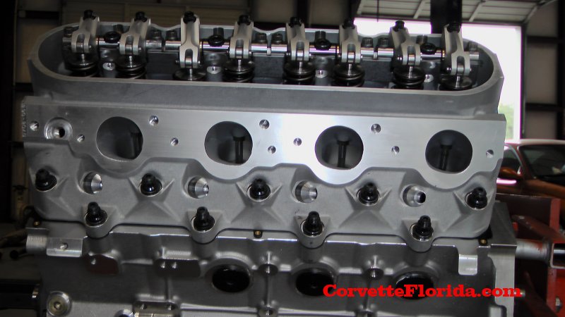

Well, here's a pic of one of the heads. About the only thing that I can see that still makes my eyes go all squinty are those rocker arms apparently pointing in all sorts of directions. Just doesn't seem natural to me, but that seems to be the way they should be. It still bothers me though.... Just seems darn weird....
They looked that way on my "porcupine head" SS-396 Chevelle, except yours are
WAY nicer looking. My 396 just had the stamped rockers.
Sure wouldn't mind having that bad boy back again! Be definitely worth more
than the $2900.00 I paid for it used in December of 1969! Still like the looks
of that Warhawk setup though.................:thumbsup:
Andy :wavey:

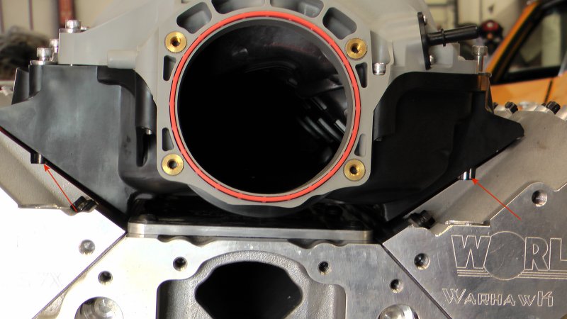

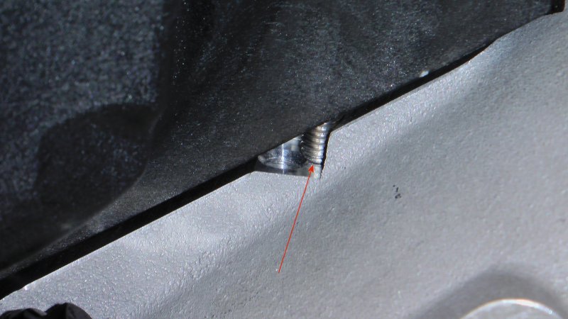

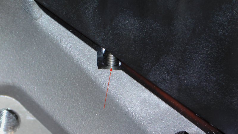

While I was out at the shop yesterday, Chris asked me to take some pics of the misalignment problem between the intake manifold and the heads. Here's what we are looking at....
As you can clearly see, if one side of the intake manifold lines up with the mounting holes on one side, the other side is a good quarter inch off.
WHOA! THAT'S not good. It almost looks like the angle of the intake where it meets the head is not the same as the angle of the head, but pictures can fib a little I guess.
Andy
It almost looks like the deck of the block is too short. I know there are two different warhawk block deck options and I don't understand how they can both use the same heads and intakes. Are the LS7 heads only supposed to be installed on the tall deck block?
